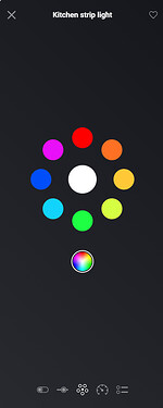

I noticed that Shelly RGBW 2 which is set in white mode actually behaves as in color mode.
Please describe the actual behaviour.
And did you make sure the device was set to rgbw2 white profile before pairing?
Could you post the output from /status of one of these devices. There must be something in there that triggers the app to add the color light mode.
{“wifi_sta”:{“connected”:true,“ssid”:“haha”,“ip”:“xxx.xxx.xxx.xxx”,“rssi”:-53},“cloud”:{“enabled”:true,“connected”:true},“mqtt”:{“connected”:false},“time”:“16:19”,“unixtime”:1711639145,“serial”:45520,“has_update”:false,“mac”:“E868E7F2DC3A”,“cfg_changed_cnt”:0,“actions_stats”:{“skipped”:0},“mode”:“white”,“input”:0,“total_power”:0.00,“lights”:[{“ison”:false,“source”:“input”,“has_timer”:false,“timer_started”:0,“timer_duration”:0,“timer_remaining”:0,“mode”:“white”,“brightness”:84,“transition”:0,“power”:0.00,“overpower”:false},{“ison”:false,“source”:“input”,“has_timer”:false,“timer_started”:0,“timer_duration”:0,“timer_remaining”:0,“mode”:“white”,“brightness”:84,“transition”:0,“power”:0.00,“overpower”:false},{“ison”:false,“source”:“input”,“has_timer”:false,“timer_started”:0,“timer_duration”:0,“timer_remaining”:0,“mode”:“white”,“brightness”:84,“transition”:0,“power”:0.00,“overpower”:false},{“ison”:false,“source”:“cloud”,“has_timer”:false,“timer_started”:0,“timer_duration”:0,“timer_remaining”:0,“mode”:“white”,“brightness”:100,“transition”:0,“power”:0.00,“overpower”:false}],“meters”:[{“power”:0.00,“is_valid”:“true”,“overpower”:false,“timestamp”:1711642745,“counters”:[0.000, 0.000, 0.000],“total”:0},{“power”:0.00,“is_valid”:“true”,“overpower”:false,“timestamp”:1711642745,“counters”:[0.000, 0.000, 0.000],“total”:0},{“power”:0.00,“is_valid”:“true”,“overpower”:false,“timestamp”:1711642745,“counters”:[0.000, 0.000, 0.000],“total”:0},{“power”:0.00,“is_valid”:“true”,“overpower”:false,“timestamp”:1711642745,“counters”:[0.000, 0.000, 0.000],“total”:43030}],“inputs”:[{“input”:0,“event”:“”,“event_cnt”:143}],“update”:{“status”:“idle”,“has_update”:false,“new_version”:“20230913-131259/v1.14.0-gcb84623”,“old_version”:“20230913-131259/v1.14.0-gcb84623”,“beta_version”:“20231107-164128/v1.14.1-rc1-g0617c15”},“ram_total”:50936,“ram_free”:36428,“fs_size”:233681,“fs_free”:158883,“uptime”:6824643}
Could you check what capabilities the device has under https://tools.developer.homey.app/
Would it be possible for you to re-pair one of these devices and see if the hue and saturation capabilities are added to the device again after its been paired.
[EDIT] Nevermind, found the issue and will be fixed with the next release.
I tried it and the end result is the same. Until I removed the remaining channels that are not used, it was fine.
