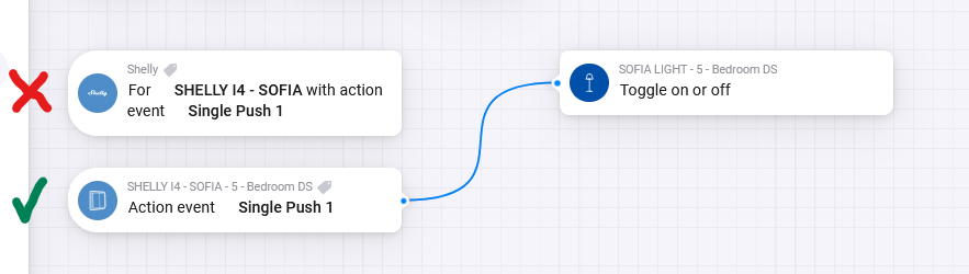

  • Important change: the generic “action event” trigger card has been replaced by device specific “action event” trigger cards. Currently the generic action card is deprecated but still works. But after some months it will be completely removed and will break your flows. So update your flows to prevent this from happening.
  • This release also adds support for setting values of, and triggering flows based on changed values of virtual components from Shelly Gen3 devices.
  • It adds an action card for Shelly Plus Plug S for setting color and brightness of device LED ring.
  • Under the hood it adds some logic to add missing capabilities upon device initialization.
This is a big release with lots of changes. The change with the most impact is the deprecation of the generic action event trigger card available under the app. It has been replaced by device specific trigger cards available under each device which support action events.
The reason for this change: the generic card was created when the number of drivers was growing and I had to add this to each individual driver. Some time back the app was restructured with generic drivers reducing the number of drivers drastically. This paved the way for using device specific action event trigger cards. And since the use of the generic action event trigger card is still confusing for people who do not read instructions I have decided to make the switch back to device specific trigger cards for action events.
The current generic action event trigger card is deprecated but still works. But after some months it will be completely removed and will then break your flows. So update your flows to prevent this from happening.

Hello @Phuturist,
I just installed the test version…
Normal usage of Shelly from the app (web or android) - All seems OK.
Flows with Shelly I4, using the new card for device trigger, are working like before - All good.
I will keep testing, and if some issue appear I will let you know.
Thank you.
