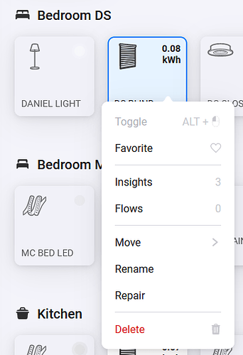

I have Roller Shutters, and don’t see any option on Homey to do calibration:
But if you are speaking about this zone:
imagem
My roller shutters work, when I move the bar for the different percentages.
It would be perfect to have that info as status indicator. :slight_smile:
imagem
You have to do the calibration through the Shelly app or the web interface of the device.
