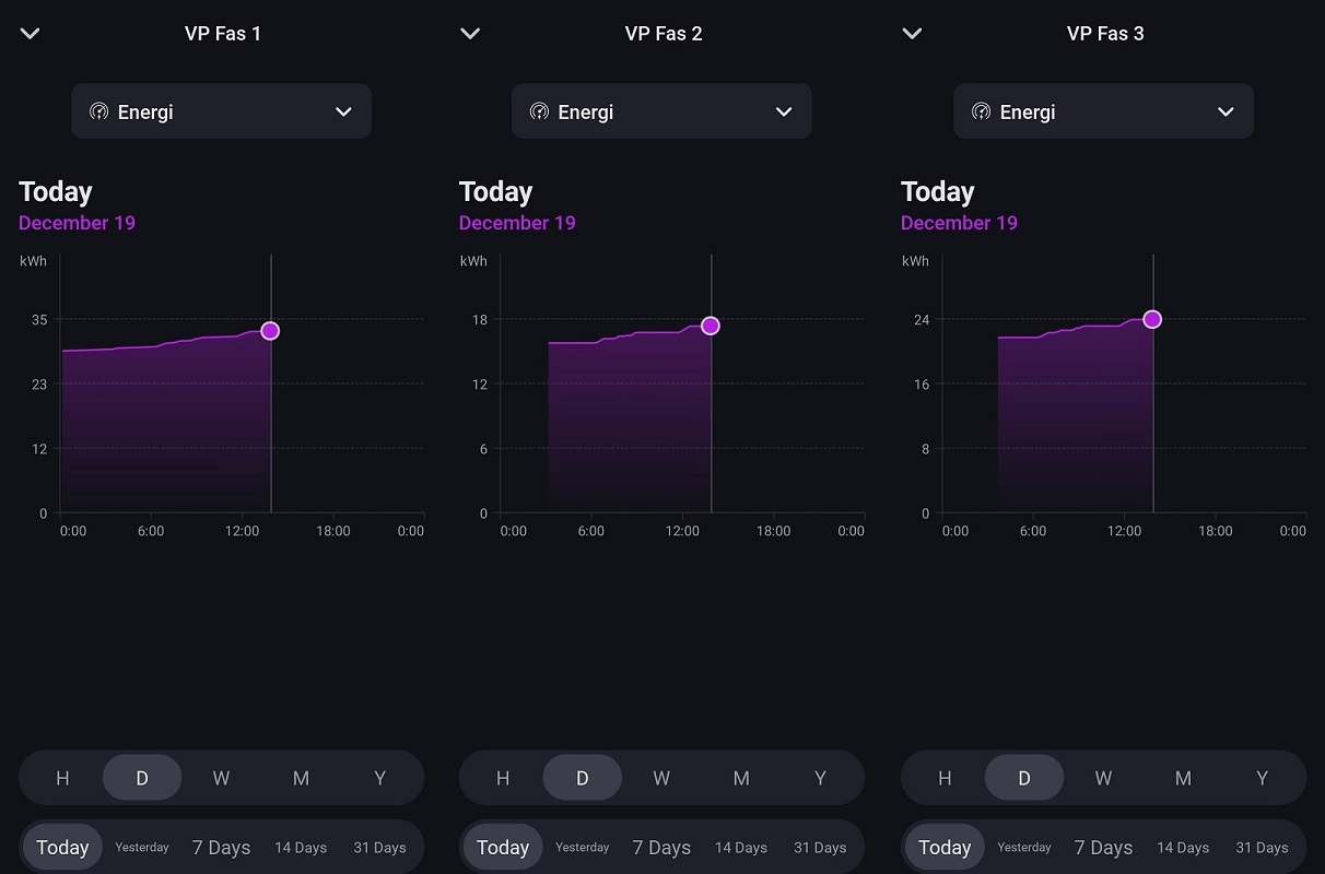

I have some issues with my recently installed Shelly 3-EM,
When I want to look at power consumption of just one day (today) it shows the accumulated consumption since the device was installed, as an example phase 1 starts at ~29,2kWh instead of 0 as i believe it should. Phase 2 and 3 acts the same and are also missing some data during the night.
Any ideas of why this is ? The Shelly 3-EM is running FW 2023-09-13-114244/v1.14.0-gbc84623 and its connected to my Homey bridge.
Not sure but start with updating to firmware 1.1.0 to rule out firmware issues.
And btw, Shelly devices are not connected to the bridge. They communicate from Homey Cloud to Shelly Cloud and visa versa. There is no communication with the bridge.

The 1.1.0 version does not seem to be released to the 3-EM yet, (it does not show as an new version in the device), so nothing there yet,
But anyhow, I also got 3 Shelly plus pm mini, all of them are updated to 20231219-133934/1.1.0- and all of them also have the same issue with only showing accumulated values.

You will have to explain your issue in more detail. The Plus PM Mini doesn’t have accumulated values. All the Shelly app for Homey does is reports the measured power in Watt and measured energy usage over time in kW of a single channel of this device.
