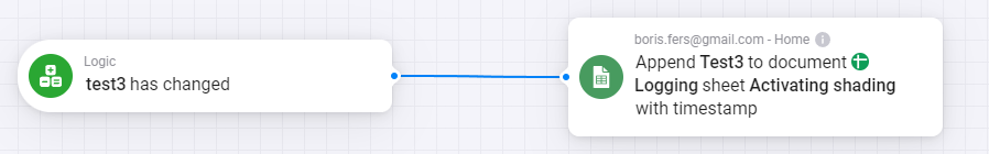

Nov 9, 2023 2:32:58 PM Test1
Nov 9, 2023 2:32:58 PM Test4
Only two triggers were activated.
Or the other variables are already 10, but I presume you took care of that. For contiously testing add 1 every time, if that’s possible.
Might be you are missing interrupts due to high CPU usage?
What happens when you start the 7 Appends card directly after the start button?
Or put some delay between every variable being changed.
2 per 60 sec. This does not make any sense.
