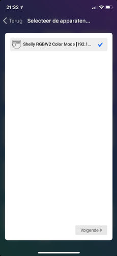

I cannot pair devices. I can find the device, but as soon as I press connect I have to log in. I have already entered my username and password, but then he gives the error message: âcannot postâ
Are you using v3.0.0-rc.16? If so, update to .17
Hero! After the update it works! Thanks for the quick reaction and solution⌠![]()

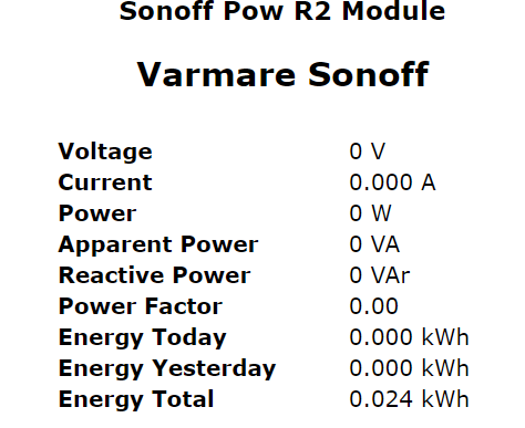

I wonder if the app also gets the yesterday energy consumption as well?
I am planning to buy 4 units for refrigerator, frezzer,washing machine and dryer.
But I want consumption now and yesterday values in my homey
Very nice if todays consumption is showed as well
It only measures what has gone through.
Does someone know how to reset 1pm? Had an outrage with WiFi and two devices did not connect anymore. One was easy to dismantle and after fixing the wires again it connected fine. So want to know if by for example turning on and off it can be reset.
ok, so its not so nice as Sonoff with tasmota ?
I might log it to my MYSQL and do a report with the data
Then I think i misunderstood you. It starts counting after you have installed it. You can get this information from the insight page.
Sorry about my bad english
I am building a Dashboard in node-red and that would be interesting to get ânowâ, today and yesterday values direct from the device.
Else I can store âtodayâ values in MYSQL I get in node-red dashboard also, ut more complicated
Right, well No, there is no specific meter to show the value of âyesterdayâ. You can get the information from the insight page, but donât think you can get that to integrate in a dashboard, but I donât know for sure, maybe you can look into that, just look at https://insights.homey.app/ to see if you can work with that. Otherwise, there is no other solution than the mysql path.
