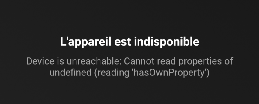

Have an issue I canât explain with Shelly 2.5.
I added the module on the native Shelly app, and I can control both contactors on it.
Then I added the module on Homey, and then the things gone wrong.
I can control the second contact
So, i tried to reboot everything, homey, Shelly app on Homey, pair device again. Nothing helps.
The strange thing that I noticed is when I restart the Shelly app on Homey, I can control the second contactor like 1 or 2 minutes and then I loose the control, and have the same thing on the previous screenshot.
Do you have any idea ?
Looks like a bug. What app version and Shelly firmware are you using? And can you send me a diagnostic report from the app settings.

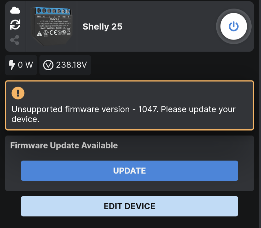

Hi, thanks for the answer !
Iâm using Shelly v3.14.0 on Homey, and for the firmware, i canât check i beacause idk why i donât have acces to general settings ⊠(cf screenshot)
I think itâs beacasue au the update alert panel hidding settings button, but the updatade doesnât want to install âŠ
As mentioned in the instructions, use the Web UI to connect your device to the cloud, give it a minute and check for new firmware. Then install it. Is the issue remains after this post back here.

I tried to to update with web interface, still the same problem i canât install new update ![]()
You should contact Shelly support. If you have any technical skills you can install the latest firmware through the API.
