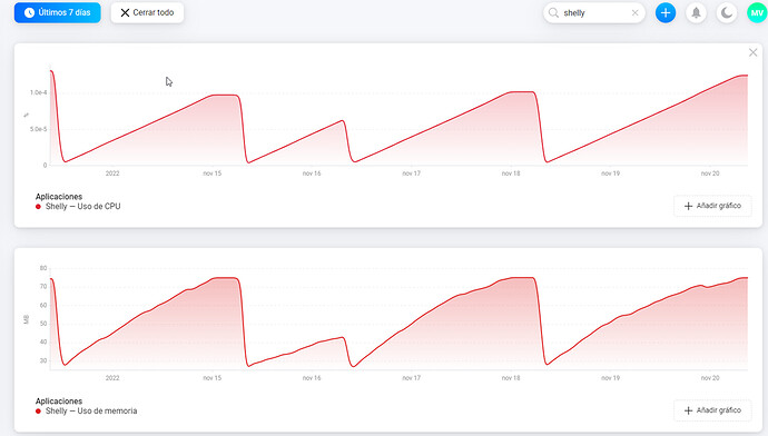

Hi @Phuturist ,
I am a user with the Shelly app crashing ramdonly. Based on your comments let me add the insights information here below. Just to say yesterday when I went to sleep everithing was correctly. This morning the app is crashed again. I am going to share with you the last 24h of CPU and Memory and the last 7 days.

Thanx, I’m afraid I lack the skills to get rid of this memory leak though. Is this on Homey Pro or Homey Cloud?
It’s Homey Pro
Are you using authentication on any of these Shellies?
No, not at all. All of them have standard configuration

Nevertheless, I was doing some validation in all my shelly devices. I figured out one of them has having issues with connectivity. It was something weird… In one hand the device is continuisly desconected from Offical Shelly app (in the app I can see device disconected and trying to connect) but in the other hand worked correctly in Homey (you know what I mean?). Casually, it’s the more far away device with really poor wifi connection. I tried to enhance the connectity and right now it seems it works correctly. From last Sunday morning I do not have more shelly app shutdows.
It’s possible the problem comes from that reasson. At least it’s one option.
I’ll come back with more info once I have it.

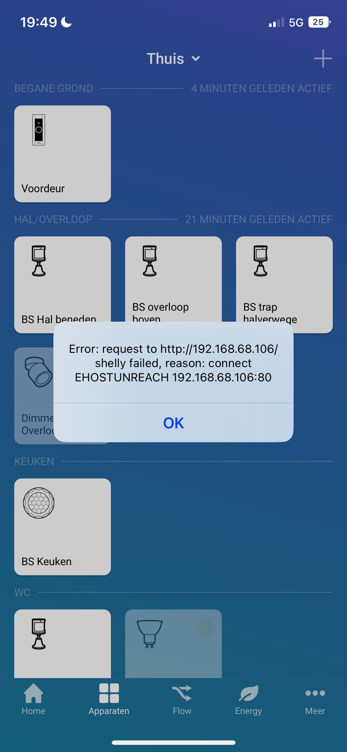

Hello everyone,
I have a HOMEY PRO and I can’t connect SHELLY MOTION 1-2.
Some times after entering the details of my account (shelly) there is a white window and that’s it, It’s stuck.
Sometimes it shows:
Error: request to http://. .. /shelly failed, reason: connect EHOSTUNREACH . .. :80
Until about a month or two ago it worked great, suddenly it stopped working.
I followed all instructions regarding pairing devices with homey. Now I find that the dimmers can’t be paired. The plugs didn’t provide any problems. Any idea?
Make sure the device is within the WiFi range and it’s awake using the wake up button during pairing. You can try to reboot Homey and reboot the sensor before pairing from the web UI. Unreachable means Homey can’t reach the device on the network. This error is shown after 30 seconds.
Check your network, reboot Homey and reboot the dimmer from the web UI before trying to pair. Homey can’t reach your device. Could be caused by Homeys network stack, something with the device or your network.
I’ve done all this, and I still can’t do it with two devices
Let me wave my magic wand … Nope, didn’t work either. I’m afraid i can’t help you. Networking issues is not something I can solve from the app. What is the firmware version on your motion sensors?
20220811-152232/v2.1.8@5afc928c
