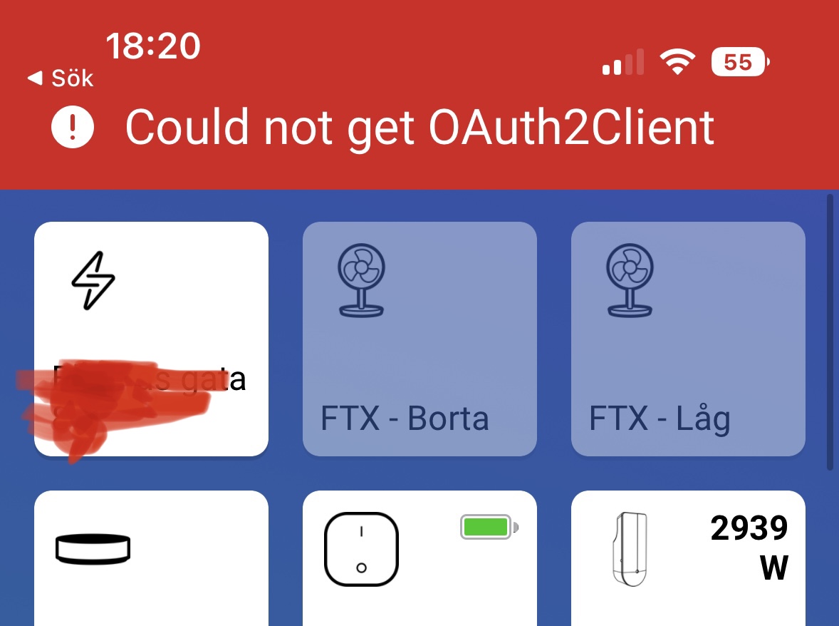

Don’t really know how to fix this (and it might not even be for me to fix) until I get a decent response from Athom. I’ll see if I can work around the issue in the code though. But the error basically means there is no valid session ID for the oauth2 client. I’m not sure I can work around that and I need a valid client to create a websocket connection with Shelly Cloud.

Yesterday it started again for all Shelly devices. “Could not get OAuth2client”. Last time it started working again after a couple of days but wonder why.
The issue seems to occur after an app update and my guess is only on the deprecated cloud driver. Try re-pairing your cloud devices to see if that gets rid of the issue for good.
