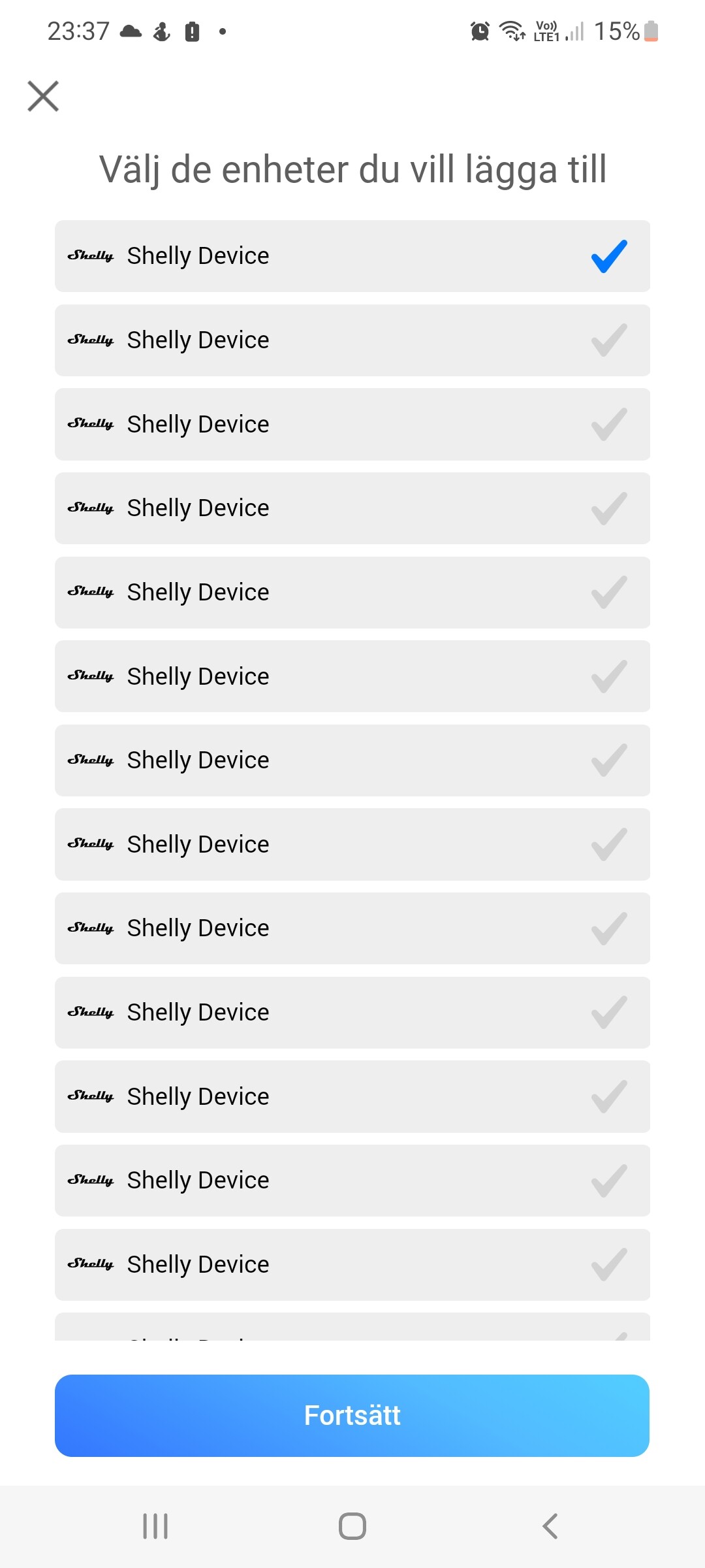

Having some trouble with the new driver. I have got a lot of shellys and they have all been added using the old individual unit drivers. When I removed one of my shelly plugs and tried to add it again using the new driver get stuck. First I get a loooong list of all the shelly units I already have in homey with no way of telling them apart. When I just take the first unit in the list, I get the following error:
Any help appreciated!
That doesnât look good indeed. It should be a list with devices model with IP addresses. The fact that itâs not is related to that error but Iâm not sure yet what is causing it. On what version your Homey and what version of the app are you using?

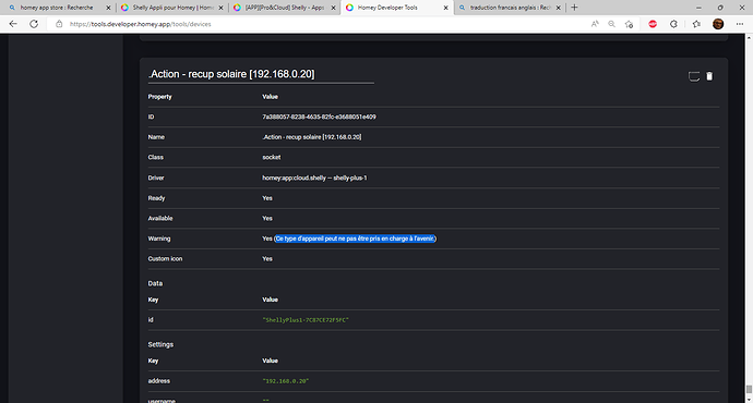

I just started 2 âshelly plus 1â buy in May. That communicates perfectly with homey. But I find that these devices are in alarm âThis type of device may not be supported in the futureâ is this really the case?. Best regards
@Christophe_Barres
I thinks thatâs the case because there is a new driver for the Shellyâs and you are using now the old ones. They will stay to work.

OK, I am on Homey 8.0.5. Just created a diagnostics report with version 3.11.2 installed. Got the guid eb042d02-b801-479c-98d7-fbda656faeba.
Thanks!
Thanx, I can see where itâs going wrong but I still have no real idea why this part of the code isnt working for you while it seems to work for at least 6000 other users.
I see you have an offline Shelly Plug S with IP 192.168.86.78. You should remove it from Homey if itâs not in use as it may affect performance of the app. I have seen weird cases where offline devices where causing issues with the app.
Another thing Iâm also seeying is something strange where a paired shelly-plug-s seems to have a capability that should not be there causing errors with trying to trigger a flow card that is not available for the Plug S. I can only see the device id from Homey in the log, you should be able to track down which device it is using the developer tools at Homey Developer Tools. The device id is 317487c2-20f4-4c22-8d23-a47757108f64. You should remove this device as well and try again.
Try rebooting Homey after removing these two devices and pair again.
Another thing to try is pairing through the web interface if it still doesnt work: https://my.homey.app/

OK, so I am getting to understand this a bit better. So I did what you said and removed the weird device. A couple of times, when adding a device to the Shelly app, they appear as something that they arenât. A least they get a different icon than other units of the same type.
Anyway, I then rebooted the Homey and tried again. Same thing, long list of devices just saying âShelly deviceâ. I tried adding the first one again with the same result. However! When scrolling down the list I discovered 1 device that âlooked like it was supposed toâ. I tried adding that. Presto, it worked and it turned out to be the device that I removed yesterday to try âupdate the driverâ (and not see the deprecation warning anymore). Here is the interesting bit. After this, trying to add new devices, I just get an âCouldnât find any devices to addâ (or whatever it says). So my conclusion is that all the other devices in the list are my other devices that have already been added to Homey and therefore arenât really âavailableâ, i.e. they should not appear at all but are somehow included when there is actually at least one ârealâ device to add. Iâll try to confirm this tomorrow by removing something else, but they are all tangled up in flows all over the place to it is a mammoth task to âupdateâ them all.
Thanks for your help!
This is really helpful and perhaps something I can actually solve. Please let me know if you can confirm this.
