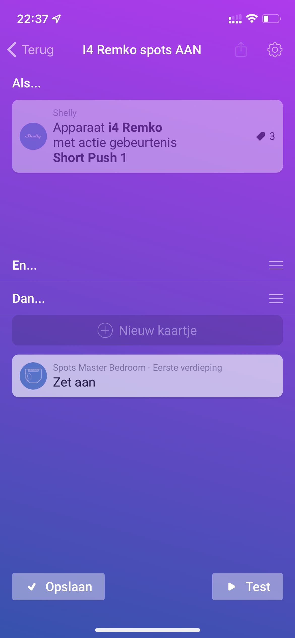

For some reason the I4 plus doesn’t react the same as the I3’s.
The flows aren’t started with “actie / gebeurtenis”, this works fine with the I3’s.
Something to check with the next update?
Shelly i4 supposedly has 3 possible actions per channel, most likely “click”, double-click, and long-click.
In the app flows for the i4 I see that the only triggers are “changed” “off” and “on”. Am I missing something in how those can be implemented? If not, any chance the others triggers could be implemented as well?
Many thanks!
Read the first post of this topic. You need to use a app level flow action card.
Ah, sorry, made a mental notice to remember to use that when I will need it, especially since I already use it for buttons, but seems mental notes don’t work as expected. Thanks for you patience ![]()
