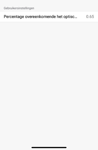

This was always the perfect middle correction
There are a lot of issue with the halfway setting. It might be removed in a future release.
if it is solved before spring would be great, ![]()
if you need to test something, just say so or pb and thank you for you Work
As mentioned, it will probably not be solved but removed. This halfway setting was added by an external contributer and is no functionality from Shelly itself. The calculation for setting a device to 50% when it does not move linear in time is creating all sorts of issue. So itâs probably better to remove this all together.
okay thatâs a shame last year it worked great for me
