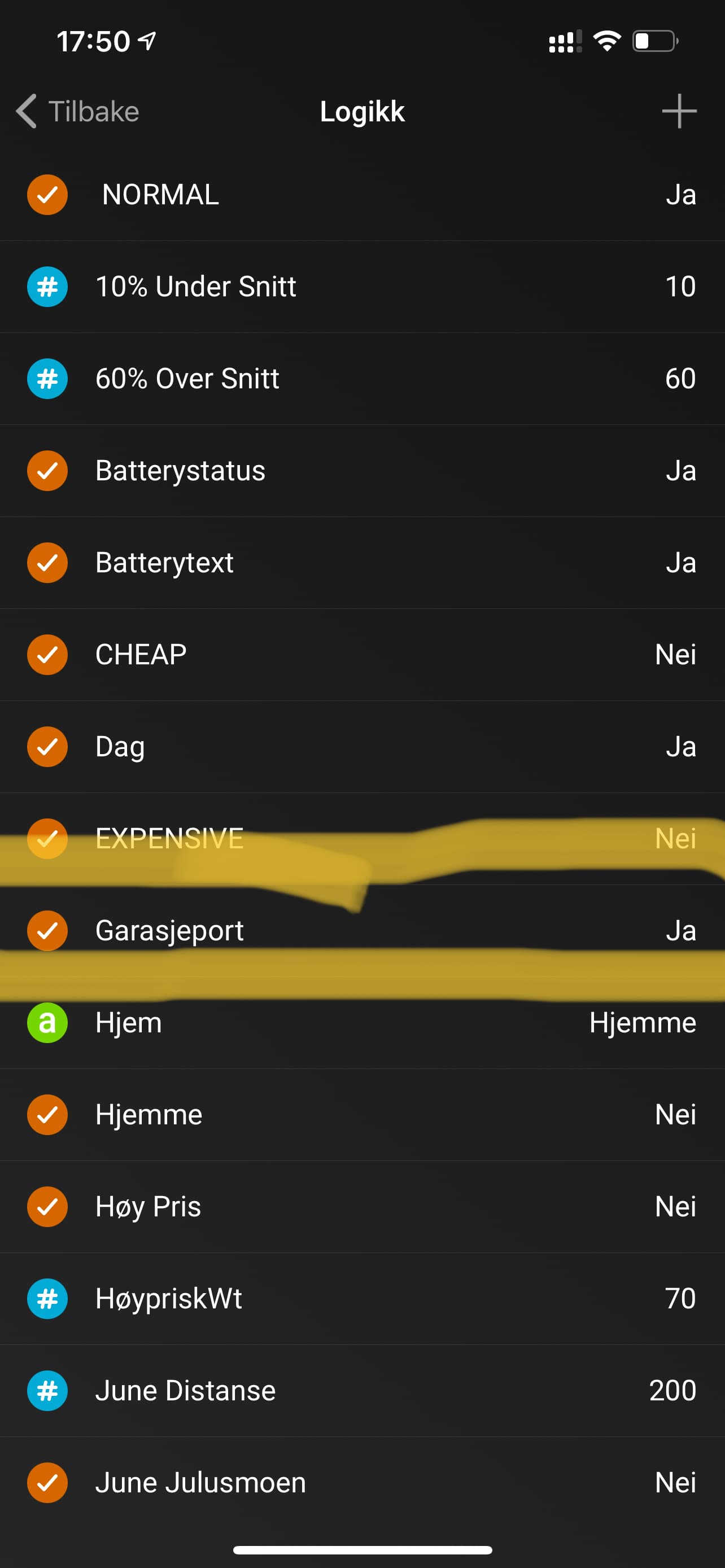

Ok! But I have some problem with the switch on and off also😄 in the settings in Shelly the button I set to momentary, but in a flow with a button I have to set it in the when card to turn on and turn off with 1 sec delay for it to work. Then this state input will be wrong.
The delay disappeared when I updated to the test version.
https://homey.app/f/q7rl9M![image|231x500](upload://vGfaCJMpdCYRpF2zOeTb1XZr7Y0.jpeg)
Ok I tried to change it with on and off and it worked​:pray: thank you so much! Made my day!!:blush::+1:
