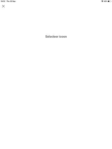

Adding a shelly 1PM device fails. App v3.4.5
1 select shelly (plus) 1PM
2 connect
3 device IP of my shelly 1PM is found
4 i use the standard icon
5 the install does not get to the next step and fails on a timeout.
Tested in homey app on iPad, web app on ipad and web app on pc. All same behaviour
This step goes well
Pressing the green button results in this screen, that times out
Ok
See the troubleshooting guide.
Did not find that one yet… thanks.
In the meantime I managed to add the device. Just trying many many times it finally succeeded.
I happened to do the troubleshoot tips (update shelly firmware, update shelly app, reboot homey etc) but they did not seem to help.
Could you send the a diagnostic report from the app settings. Perhaps there is something in there that’s useful for me.
Done, see pm
As most of the times the log is completely useless. Can’t really say what’s going on. I’m considering it as an incident as there are no other reports.
