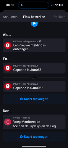

Problem found! If a single capcode is alerted, the first digit is omitted if it is a ‘0’. With multiple capcodes, that doesn’t seem to happen. I solved it like this:
Still not working, both not

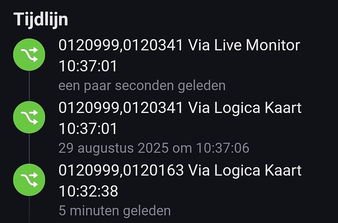

Ik have running a test for almost 24h on a very busy “capcode” it only triggered once :face_with_crossed_out_eyes:
Also tested “als een nieuwe melding is ontvangen” then sent capcode. Then I got correctly every capcode so for some reason it cannot filter it anymore..
