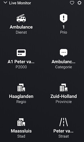

You can also check if you long presh on your device it wil show a “live monitor” and wil show you all the messages.
This will refresh immediately when a new P2000 is comming.
If this works for you you have to look how to build your flow… There’s nothing wrong with this app…

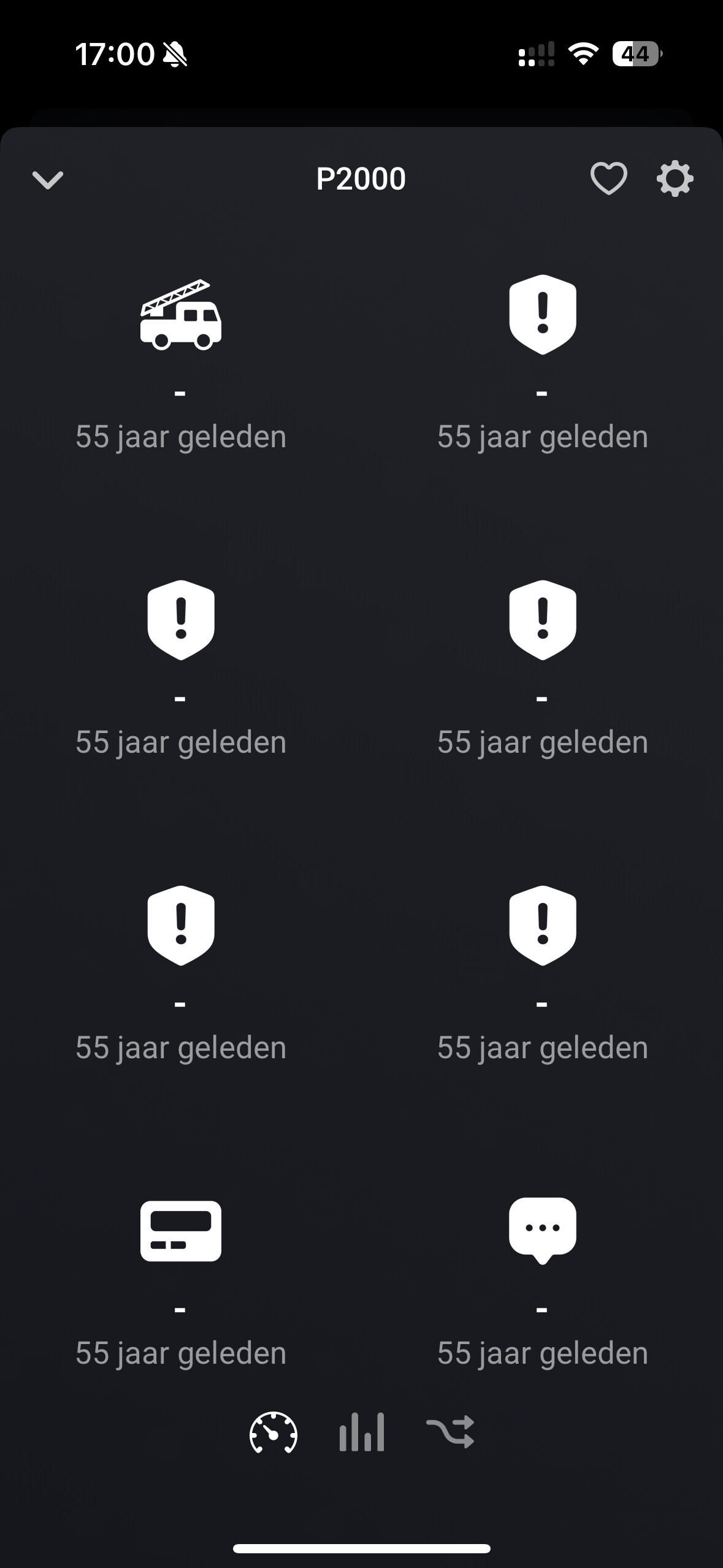

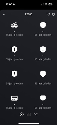

I think, i have no connection to the server
For 55 years i see… remove your device and add a new device, hopefully will fix that
I have tried all sorts of things by now. Completely deleted the app, installed and started a new device. Result: still no display. Does anyone have any other suggestions?

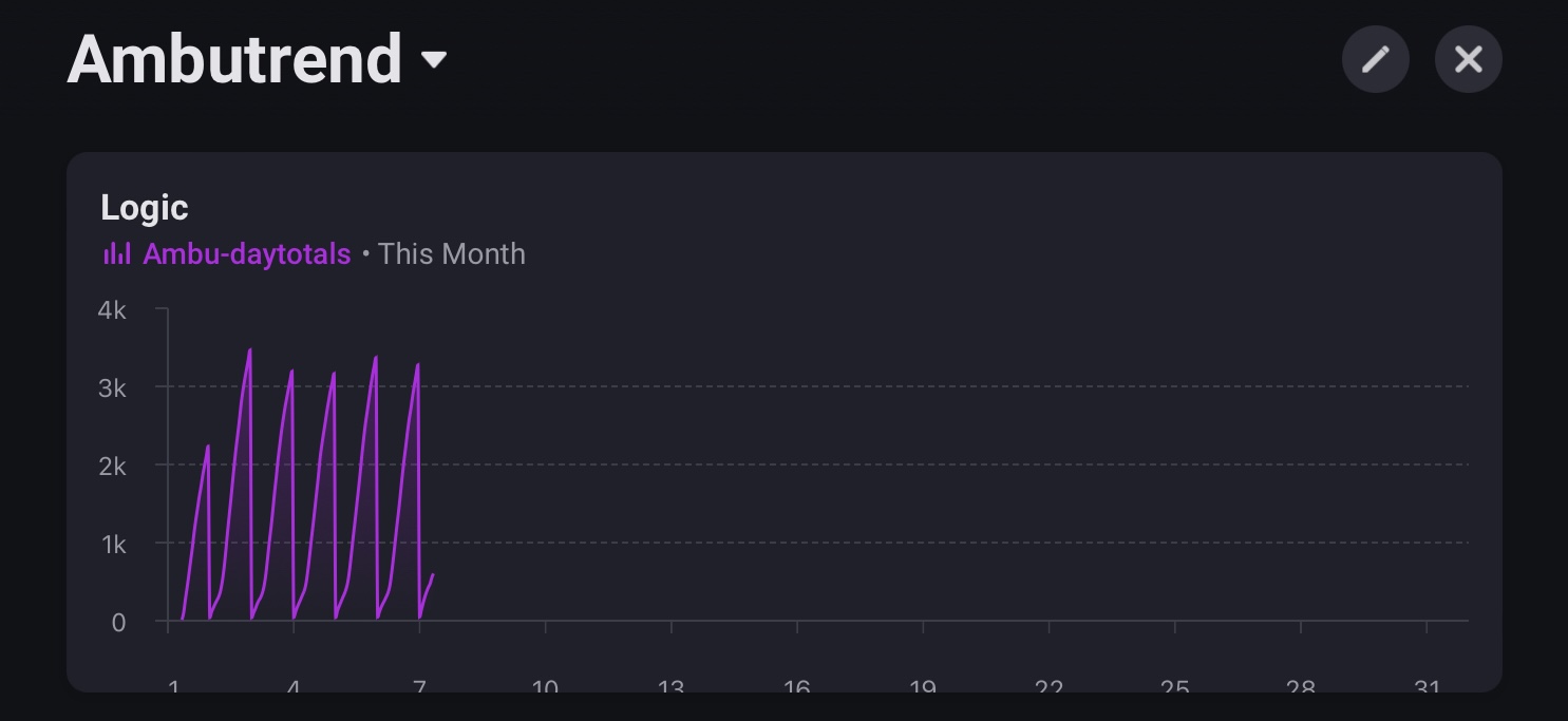

Edit: so the loadsharing works. With 3 alternating flows each triggered by any p2000 event, homey cloud is allowing it without auto disable the flow. It never missed an event.
Btw, just made a widget on the new dashboard functionality as a test
