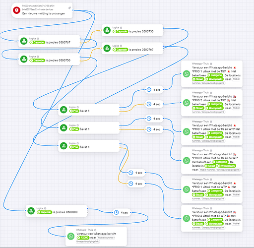

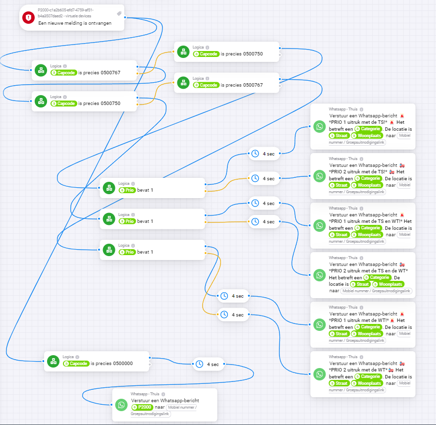

Not all of the notifications that are filtered in the flows comes to the whattsapp message. Today for example a couple of incidents of firedepartment in Brabant S.E.
I did make a flow who should be triggered at capcode 0500000, it didnt work, are there codes excluded? He has to trigger multiple flows, can that be a problem?
@Berjan_Rood Maybe you can post you’re flow over here. This capcode is only once a week I saw.
Are you using other capcode that are working good?
Did you restart the app after it is updated?
Last week it also didnt work, so i thought is was the whatsapp app who gives the problem because he has to send a message to 6 numbers at once. Thats why i build in the delay. P2000 and also whatsapp are working fine in a other flow
Please check your flow lines!
Build the delay like 1, 2, 3, 4, 5 and 6 seconds instead of 4sec for all.
Also you can use👇🏻
Thanx for your reaction. Those whatsapp messages are never triggered at once. Always just one. In the other flows i use 2, 6, 8 seconds etc.
