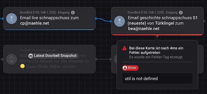

Hi there, my flow suddenly stopped working with an message:
door bell ring history is not empty, I just rang my door bell.
Only thing that changes is that I got a new (i)Phone…
The other E-Mail few on the left runs just fine…
Any ideas?
Have you tried turning it off and on again?
Yes, I restart the Doorbird and the Doorbird app for homey.
… and Homey, to be on the safe side…
Send me a diagnostic report after running the flow. I’ll see if that contains some info. It’s weird though as there has not been any update recently.
4c769926-36b7-4ade-8177-93a3fa1696dc
I am pretty sure the mistake is somewhere on my side, I just can´t figure out what it is… I didn’t really change anything (other than a new iPhone)
Nope, it’s a bug in the app that has been there for quite some time. I guess you never used the history snapshot email card. And apparently the other 1000+ users dont use it as well. :thinking:
