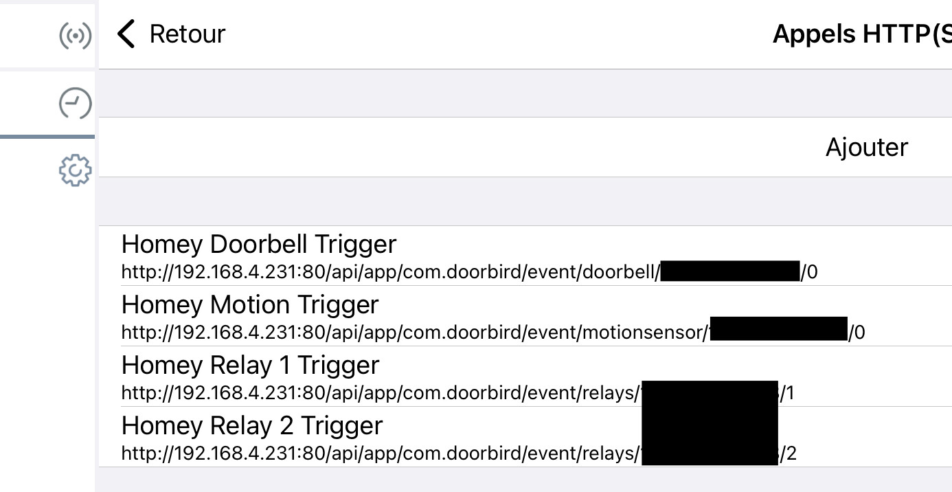

Doesnt sound like a bug but a misconfiguration of the http calls in the DoorBird administration area. My app has added 3 http calls to the configuration to allow the DoorBird to inform Homey on events. Usually it also schedules the triggering of the http calls on these events but in some cases this can not be set automatically. For instance if a user has already previously configured the http calls.
Go into the DoorBird administation through the official app and make sure to schedule the right http call for every event (doorbell, motion and relay).
Thank you for your response. I have that
This is just a list of the http calls. You need to schedule them for every type of event.
I am a dum… i have Wrong scheduls params
Thank you !!!
All is ok !!!
