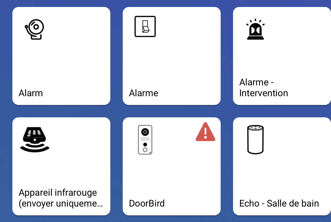

Hi! Same issue here.
This app was the most stable but not anymore (since v6?).
I tried to add again my device (not detected but test ok with the ip/login - added manually -).
But the device is still with a warning icon and not working.
Yesterday with an app reboot it was ok, but not anymore. I did reboot doorbird as well.
Any help? (Report id 5204fc3b-b538-4aef-a210-57bed38139a2)
Thanks.

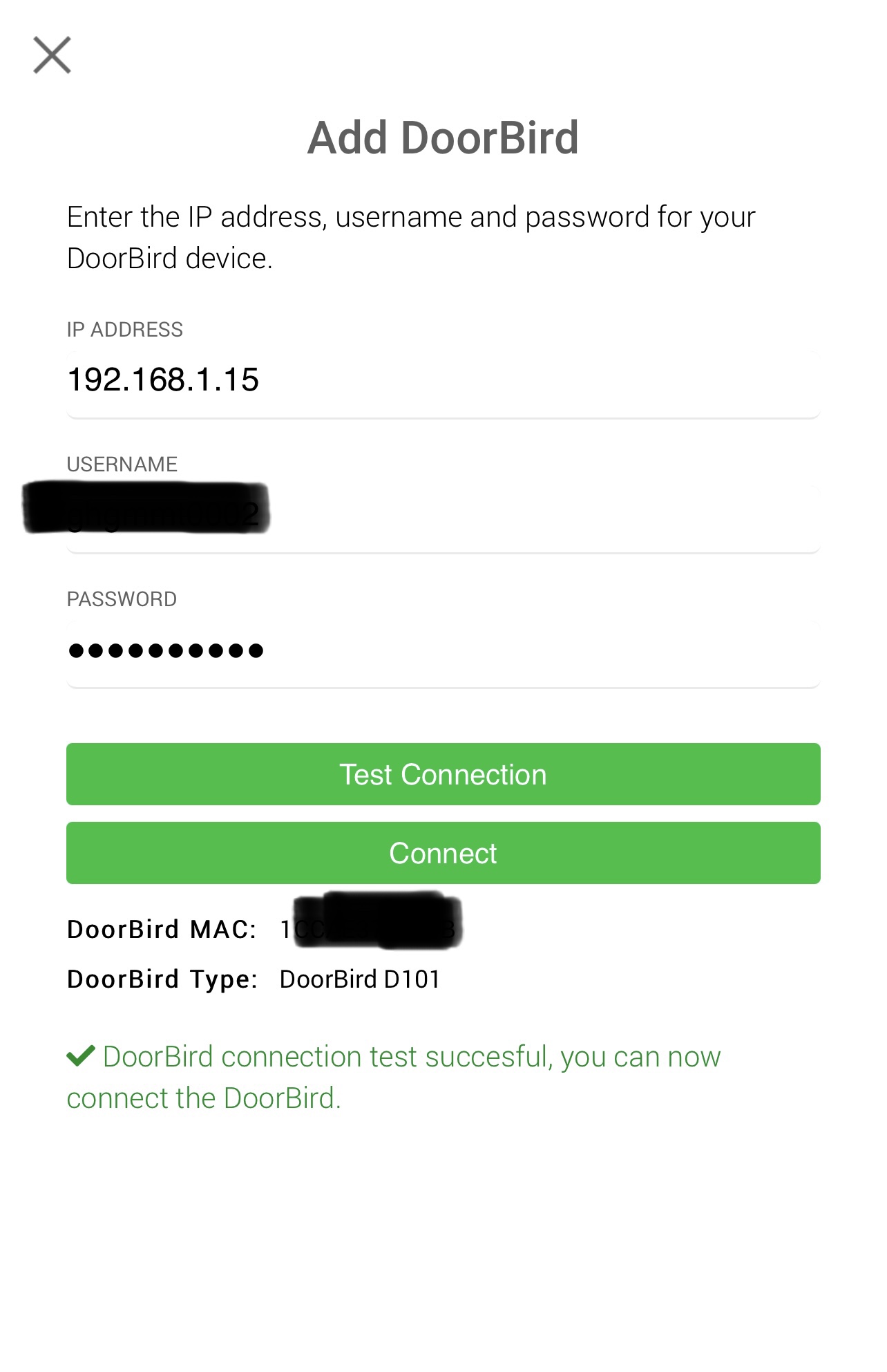

Hi @Phuturist ,
Thanks for your very prompt answer!
This is weird, the test connectivity works:
But after the add, still the warning icon and « device not found »
Still investigating… but definitely not a network issue (tested the brut http api from homey)
I asked on the developer slack channel and have more information. Appearantly the discovery mechanism can also register a device as being offline if discovery fails. This will cause issues when devices are being paired manually because the device was not discovered over mDNS (due to using VLAN’s or misconfigured networks). Why this only now is starting to give troubles is unclear, it seems firmware 6.x may have introduced this behaviour.
I’ll be submitting an issue about this in the Homey SDK so Athom can investigate it further. But you can still fix it on your end by making sure mDNS works and the device is discovered on your network. Google your router brand and mDNS for further information.
