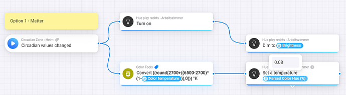

when I discovered this app I was quite happy as I am hoping to get a substitute for the natural lightning from the Hue app as the scene is not accessible through the Hue API. Somehow I am not able to make it work. Maybe somebody can help out.
I’ve added a circadian zone to my home.
I’ve then created a flow with the trigger “circadian values changed”. Using the tag #Brigthness to set the dim level and do a calculation as described in this thread to get the color temperature.
When trying to start the flow the brightness seems to not be available. Setting the brightness to 1 and 100 seem to set maximum brightness, but the color temperature seems not to work.
The result of the color calculation is 0.08. Maybe a factor of 10 to low?
Could somebody post a working flow and give me a hint why the brightness is not available when starting the flow?
BR
Marco
@Jumpingtrees
For dim value it is good to know that in homey a dimlevel is always betweeen 0 (0%) and 1 (100%).
If you test a flow with triggercards and a trigger card has tags, you always have to enter a testvalue for that tag. If you want to use the actual value from the device, select the capability (brightness) from the device itself (like you did with colour temperature) in your flow.
The colour temperature depends on which type of colour temperature your lamp device needs. I have light bulb who can handle the colour temperature directly, and light bulbs who need the converted one.
