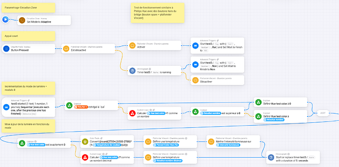

Hi everyone,
While testing replacing my hue bridge by Homey this forum helped me a lot, and I would like to share with you what I did.
I tried to copy the short press (change colors) & long press (change brightness) including the time dependance on those parameters with Circadian.
Because it’s a test I use a Hue smart button without the bridge and a E27 W&C with the bridge (but I tested it also without the bridge and it works well)
Sorry the screenshots are in french but here are the explainations :
1- First a manual command to parameter Circadian to automatic
2- Short press :
–If light is ON and I did not make a short press during the last 5sec then put it OFF
–If light is OFF then put it ON and go to the brightness&temperature trigger & reset the light mode
–If light is ON and I made a short press less than 5sec ago then go to the brightness&temperature trigger & do not reset the light mode
–Brightness&temperature trigger if reset light mode is ON then reset a variable to 0, else increment and if it is 8 replace with a 0 (8 light mode), then if it is 0 set brightness & temperature with Circadian values, if it is not 0 calculate new temperature & keep brightness. Then start the 5sec timer used before
3- Long press:
–If light is ON & transitions are not already running then start a transition 5% to 100% during 10sec, 1sec by step
–If rising transition then set brightness to step value and check if it is the end of the transition, if so lauch the falling transition
–If falling transition, … same as before
–If button is released then stop transitions and the light
If you see something wrong or could be made easier please let me know,
And if it can help I’m happy to help :slight_smile:
Here is the long press flow

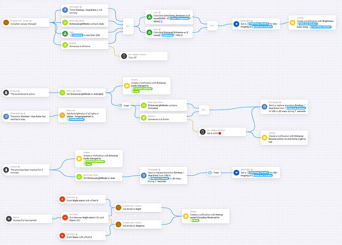

Thank you, great app.
I use it for my entrance light.
and triggering dimming up and down if my outdoor hue sensor is activated.
The Note to timeline is usually not connected and updating my timeline, that would “spam a lot”….I used it in the beginning to check if it did do what I wanted.
Works flawless for my setup :slight_smile:
