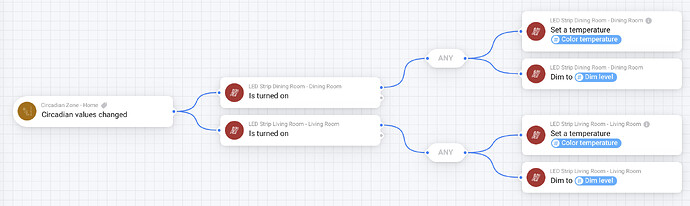

So would it be something like this? I will test it today in the evening. Just one more question. From your experience, do I need to convert the color temperature values to Kelvins? I think that they are set in Kelvins in my LED strip controllers and I am not sure if they will react correctly if the sent value is in percentages. If not, I will test your proposed solution of converting the value to Kelvins.
Looks good.

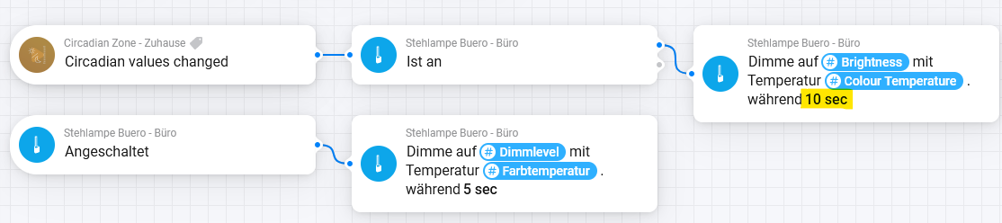

In addition I added a trigger for switching on the light (second trigger). There I set the global tags from the Circadian zone device to dim to current value without waiting for the next dim change.
When switching on with other trigger (Alexa for me), the light will still switch on to the last dim value and dim down/up immediately. I can’t dim the light “in background” because a dim value >0 will switch on the light (Hue).
And you can add a duration (right click on the card and select duration) if this is supported by your lights.
