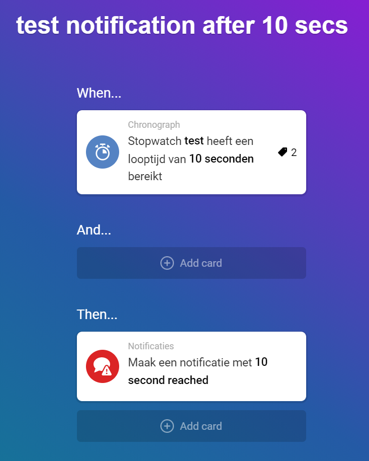

I have started using chronograph recently. Timers work fine, but I think I found a bug in the stopwatch functionality. To illustrate the bug, I have made three flows.
Let’s first show what works.
Flow 1 to start a stopwatch
Then flow 2 to create a notification if it reaches 10 seconds:
So after 10 seconds, a notification is created in the timeline. All fine.
The problem comes if I change the action in the first flow. I do not want to start or replace the stopwatch, but I want to start or resume the stopwatch. Like in flow 3:
If I trigger flow 1, then I get a notification after 10 seconds. If I trigger flow 3, I do not get a notifcation. Between the tests I have stopped the stopwatch obviously, so in both cases it starts from 0. Also in both cases I see the stopwatch is running on the configuration page.
Am I missing something or is this a bug in the app?
Thanks for your respone in advance.
My guess:
When you start flow 1 stopwatch starts to count up.
When you start flow 3 is stopwatch already beyond 10 s.
You can check this in the Chronograph settings where you can investigate what is happening.
