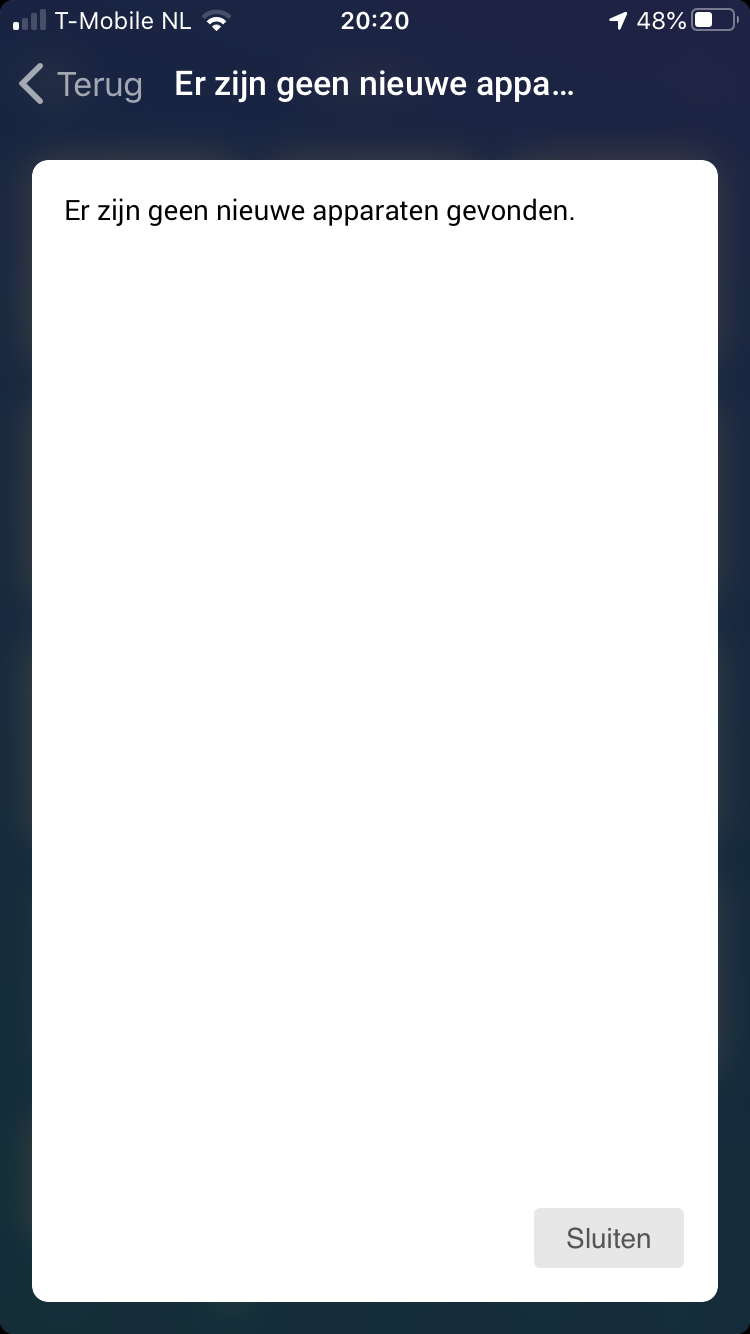

Hi, I seem to have issues using the app. I cannot add new stopwatches timers or transitions. See screenshots. Any ideas on how to solve this?
you should create them from within a flow. And then you can create it as a device, but that’s only for showing the timer / stopwatch, it doesn’t do anything. The flows initiates the timer / stopwatches.
Thanks, that is enlightening. It appears to work now. This app works slightly different from other apps and I can’t find any documentation but here. Much appreciated!
