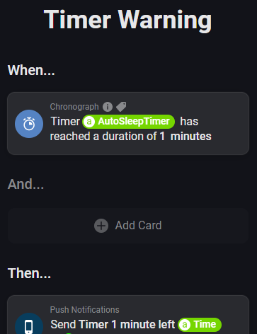

I’m trying to use the ‘Timer has duration’-card, but it doesn’t seem to ever trigger. Does anyone else use this card? Don’t know whether it should trigger when the duration is left or duration has passed since starting it.
I tried using it in different ways and trigger a notification when duration is 1 minute, set the timer to 3 minutes. Also tried using it with seconds. Never get the notification.
Try it with the timer name entered manually, instead of using a variable.

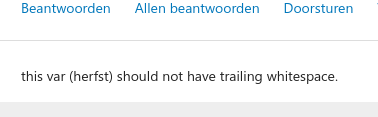

There’s a (long time) issue about standard flows adding a trailing whitespace to variable values…
You can check it with a Timeline notification f.i.
These are my season text variable values without any whitespace. But somehow it gets added. The ( ) signs are not part of the variable’s value
This is the result, when I use an Advanced Flow:
Oh, and your timer trigger should trigger when it has run for 1 minute, regardless of the timer’s duration you entered. Which has to be higher than 1 minute ofcourse.
