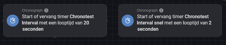

I’ll show an example of this in a minute.
Here
Will give you this:

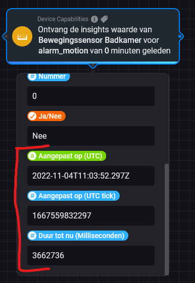

Okay, ready: You need to update the Device Capabilities App to version 2.8.3 which is in review/test right now.
I have added three tokens to the Retrieve Insights flowcard:
The next card Retrieves the Insights from my BathroomMotionSensor from 0 (zero) minutes ago, so, the current one. I have added Changed On, Changed On UTC tick and Duration till now (in MS).
You can use this card to check if the duration-till-now-tag is more then 24 * 60 * 60 * 1000 (=86400000).
If so, add this to an alert.
Here you go:
[tef:FLOWS:"H4sIAAAAAAACA81Y72vcOBD9V4wpFI5VKsuyfvhb24Oj14+FgyOEZSSNsiZee8/2Jg25/O83Xu9uuu2Gui09GsImtuTRzJv3nuR9SLdp+ZB6k2XCRGQYo2FSWc1MYQyLWaEQMkCd63Fek5bp667C5M+L5I829H4F9U36+LhIb8dhmyFEtJJp9BmTksKARWBeeG0Dz+nXHMK8gWHA7v51jd2QLtKBbvVDVzXXu3DDblp98U+97Wkaq4aL3/G28vgWNuCquhoq7A+hppHkZGgMAml5+ZBWNEMHnUeJgYWCA5MQC+YsGgZa88glYgyRkhiDfcCmb7s+uWu7G8om8Sv0Nz0NYloO3RYXqR/X5cEV0fPITHCSEFOSGY858z5mXhaAeQzjvI9pmSm+SO/3f1taYtWu8b5cQwPX2JV1e115ij/meQtdBa7GZY/Dcg/HhA34oWobuqCqL1MVFSijFVMKCejCegaukKxw3EWOKJRV6dUOgYdj0PH/ipKa1yZCA9b4eaPGTkO9He8nO4yNNV5lRWQ+hkA4cMGsKxzLc4PGCReFk3scPkFh6jbsOr8raBacV7SeFy5zKDkzaC2TQkRGyzmmnOVcgvVg5FT0lOXf7Tbx0CQ1Dsmwqvok1u1d0m2b5G6FTXJPw3fQDIsEwa+SVbvtkth2SdVQeo1Hys+3ddtRpHus6VG6cSyFPu+qMKzSstnW9SJdYXW9Gg5XY41NO+CI2ax+nbJFmBO2wGZTflUPE4kmqiz9YeR+SRQ7SyPOCy2dDEwTakxGnTG7AxOkcTpKwtQeaRR26x1JlJOUfBFzpql3VBJkzETOqfG5AK6NkzL7hER4h9fE5r7fySt5A+GGRroRnKdEj8Ghhm69XLf7ZPdBPrt7jcNE60mW/eEyQt0jxW22a4ddG6lRI1NnFTv1QPGpBzn/qmKvD+bl2yZU+8zaYUQ3jwZ0EUhmUQpakPptUCGLOQkGtDKRqErojhmSpLkhE9aOBaNptg5EbEqXKROUDVnMafzYC9+uN9DBMBLTSL77WaTLF6FrN0N7g82L5bHZZTmHfWUZthSQ5g9VXTdE9BGzTFoD6BX5Q0Hqtj6QZZIseVCZRLC5CCdqq2LybnjZJ3XbEFAkOJKYkMlvieKHj4xSfUZVB9gFn6+sWSBPXbVmdldn+/C3NO1n+fDl5ZlC/p0T/OrqKMSkaZukw37TNn11ixe79s8q79S2pPj5tiXyIkdLm4U0mabNIqPdQKFmtCNII1W+o9gztuW8tCjBMOsNPYt05gEeSBB5QfTLEaUMz9vWe9ySuP5H05pV6qlpSfkjpiVlIXJZ0PnI0flI2qhoIyYDoES0QemjQPFkWgIVbf/oiRaKzlWIlhmRZUznGeqgIs3W32taM7h33rRmlXBqCTMwm2sJ3wTJL2kJE8nPGsKs4k4NoVA/3xAk1zY6D9RxQ1wpMuq90YZ5CzETCNob8ZwhoEAuBRlCBvSEBA1sNAgmOTqhBb04ePWE+Nu/kvd0XGzJCz4MeHPz7AmmbdoYn547XD4n//HyS/XPqutU/YX5oSML5FkWaDdFMkImfe4YBDozZM5aYUFmquBP6i98BKHJQYMTns7i3jELmg5Yuc+LSDtvEeA71T+HaOfVP6uEU/XPwGyu+r8Jkl9S/V8y/KwTzCp07wRyglmfN9l1S9LBPc6bbb9aDvhx+BzdXbBtT3obX/onAL78JmIx4Tjr6wyau6YExnyGYdOXr17BprqAgbK7ILK+Gheje7dA76ljAuPAuzH6iPUuxTL9EaQJxsfHq8f/AB8k6nmCEQAA":/tef]
This is not very memory heavy, since you don’t need to activate much and don’t use any variables, flows or triggers for the sensors, you just run a flow to periodicly check the already existing insights.
Works for numbers and OnOff.
This is the best performance-wise solution i can think of.
