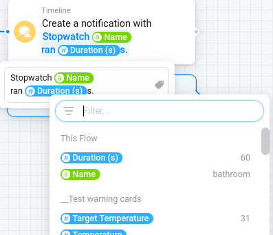

Trying to start a stopwatch, then stop it and create a message “Jeroen came home after 1 hour and 20 minutes” but i see that there is no card available that has the stopwatch time is that correct?
To be honest, i also cannot find it, or any other way to know how far a stopwatch is: which seems very straigns, because why then would you need one, if you don’t want the result?
You can wrap a device around a stopwatch, and then there is a sensor showing it, but the tag that belongs to hte time has been disabled (not sure why that has been done).
Maybe @Peter_Kawa can shed some light on this? How do you use Stopwatches Peter?
Before i implement something that already exists.
It’s build in @JB2K
  • flow:
    (stopwatch returns only seconds, so I have a small script which converts it into readable timestamps)
  • available vars from stopwatch card:
Screenshot from 2022-10-28 16-32-04
  • timeline:
Screenshot from 2022-10-28 17-09-40
If you like you can import the flow with this exchanger file:
[TEF:FLOWS:H4sIAAAAAAACA6VW2W7bOBT9FY6A1jYSOtS+ZNJB0XkIBshL89CH2AgoLrYwEmWIdJMg9b/PpRZvdTtuEyS2SF6ee+65S/TqcCd7dbiMgsiPOXajgOEgDWJM45RhL/J8P0/SUKbE2iknc+6F0nWDbmnpXDoMNnS74Ww2l45pjcqpFGVZPylhpmzZ1KpeNHS1HAA+7W3BHVZXU2qW8Al/4kWzpliZwfbWbt13W9YBdbKHV6eAE8b9KKGpxFGSChwkLMa5pBFOYuqHcUTChAZAsGVs6tUTNWyJjNAG/SOaWig4E05mmrVoo3h1JPeJiJiLSRSCBjLxcJKDJKmUoEwS5m4UW7tnJwvIpfPSfRkrgKGNATwN5OZAMknckDJg5XOP4oDkKU5JEOHUy12ecGCesAEp6qBci1UDVqtBRler7IcyXrbx6yGox8G9pUKZKWobG20VpJXYN/3YapgL6vrUDTFjVEKySYRBsgDHOXPTVKbMCwd6Q5xvIVevVoL39ExTLBai6bVyQl9wD9yC0DzEARUEpzwC3XzXy0MaydSTzvynwVCXBDJMCCYx5zgII0hYmHLMqStdl8VCCNIHk/Rp85ODcCqqKHDKVG0KWTBqBdR9HKwR1IjH/aOTQhvxbA4K7eGhDzXLzpE7y2x08zmaqYYqJKG/fhlBC1YrrudzPZ2pMdzvKGbZOSrDdXCnFvP5pJXVz8FNznPsujE0AyMuTnyfYI/4NMhJQnkaHpWwF72tSn6hgr3YJ2EuApwnYYJhcjFMJQNpeMCEF0rppeKggo/ai4uvBRPZWVOvo0pL2lSPVW25Pdqhcbqgz+p8OyIEI6GMA4ElYeA6gTlGU5fhyA+IKxPIaH7Yg0fqvjECSUv9gxDOyrwN4azmPSwR//sSOT39O8rNWn2qufhSmOXHZvFZmHWj9H1bp8fF0lI/axYM44QBMiBcXaFPtfoqGoP6BkKmRuPlGsbCBJmiEtfo81qhJyCBaLNYV0IZNC7UYD6ZqVLsLt9YI/1A5tczNZyYj2UJB6TdKiQab41v0GiEvn1DextrxYUslOAT9DpTCH7gSNelmJb1Ao1Hd4XWIMCWy2hy3Zk1rT7jNrV2b4MEPHUgHNz3Plrrr7RBS9i7A+mnsqzrZszRFYL8kMnWoDo2eNcagF20Z6V/YPWut7J2IPL9sn5CVKPR7W12d5fd348GAFbW7F8AGY/ICF2g5WSqS6jtMfYmsJw52cyB7/60+ump3js94foZLet1oy/RM6oKtYaXAfvY6zLqrb8shUIEYfwB8UKvSvqyFezvbg1cl+gD5BP9BQ/gfIn+vEEurIDLet1c2u+sXTRC2dWkXc6cnbQ7qGqAqixUZUugh7Ic12aH1nE+Dah3gHoA1BZQ7wF2kYoBr1+qI7gjDWo1MvtKXF19r8XvStFhHYrxNi06xEM1fl+MrrFsx245/mG1ff9+zwVsbFv1VHZ/FtBROEfBILQ5weDmDAYn0nNxMkH76Tnl3T5sB9gW9WIX4sWWxzW8vLQ3oID6K/AeU1GToa7xTvdda9/NgMF8GBHd0W76jTsz2/Zo3PZ978fuTOAXeHdTEP2/qX3D6Eco/Bv4/bcteCHZbOab/wBhF4IpSQ0AAA==]
Running stopwatches/timers/transitions can be shown when you install the devices for them.
Afaik there is no ‘Start a flow and return duration of Stopwatch A’ possibiity yet.
You can trigger a flow when a stopwatch reached a pre-defined time, which also can be defined in a variable
Indeed by enabling the tags from the installed device, you can ‘ask’ in a flow for a stopwatch duration while it is running. For now these tags aren’t available as you noticed.

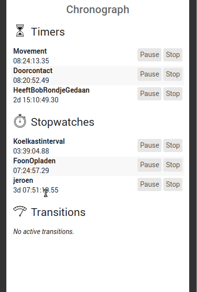

My stopwatches keep running and I can’t stop them. Anyone else having the same problem?
I already reboot Homey and tried the test version.
True, they’ll keep running until someone or something stops them. :upside_down_face:
You can stop it / them here:
https://tools.developer.homey.app/tools/app-settings and select ‘Chronograph’.
Else, you’ll have to add a ‘stop stopwatch X’ card somewhere in your flows.
F.i. at sunrise, when you don’t need any running stopwatches anymore. Or when everyone’s asleep, or when everyone left the house and so forth.
When I now try to stop the stopwatch at the configure app screen. The stopwatch is removed but after 2 seconds it’s starting again at the time that I have stopped it.
Normaly it has worked that way.
Restart the app did not help.
Version 1.2.3
I think maybe that is also caused because I am not at Homey 8.0.8.
Will update later.
Did the update today to 8.0.8. Chronograph app is automatic updated to 1.3.1.
I can not stop or pause the stopwatch with the buttons in the app config.
Yes, somehow there’s a new bug so it seems. But I can still stop it using a flow card
