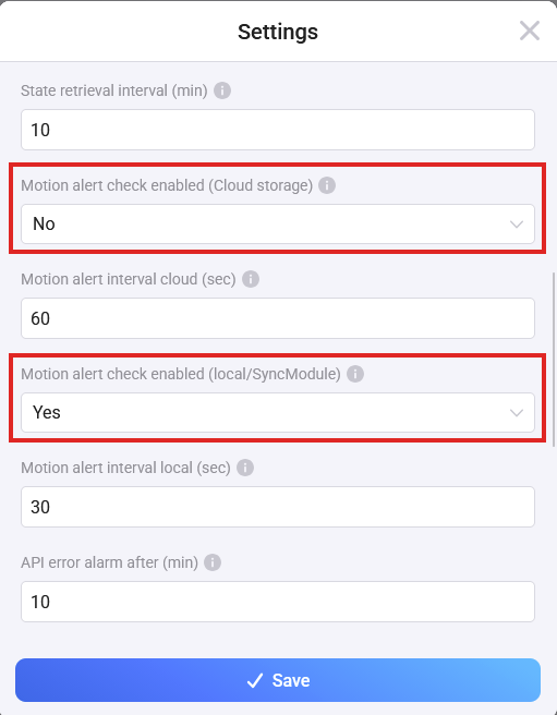

New test version 2.0.4 :
addes setting for local/cloud video check in account device settings
The previous version only had one setting to activate/deactivate video check. The decision between cloud and/or local was done based on an active subscription.
The possible subscriptions are not clear atm. So I added a second setting to control both video checks manually.
Please deactivate the one you don’t need. If you have a partial subscription (camera based, not all cameras) and you are using cloud and SyncModule , keep active both.
