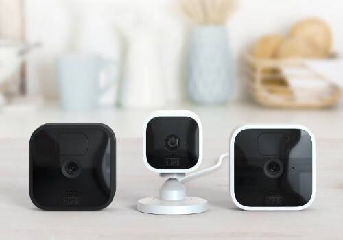

[APP][Pro] Blink for Home - Smart security designed for every home
Blink comes with a completely redesigned app!
large
This app support several accounts.
For each account you can add your devices like cameras, Mini cameras, Systems and Doorbells.
