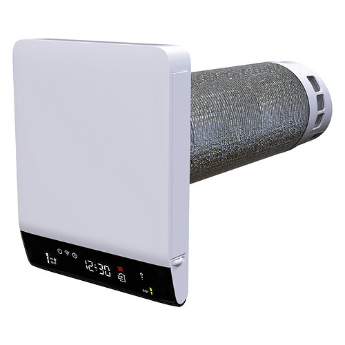

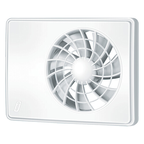

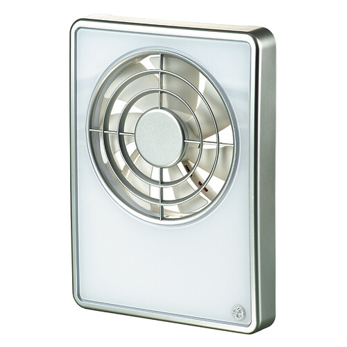

But this Vento device are 8 years old, Smart Fan Wifi is 5 years old, I was thinking to replace them with a new generation:
Are these new devices supported in the app - or in the near future?
Thanks
Or the same product but in reality manufacturer for Blauberg:
Vents:
All I can do is guess if they will work… :roll_eyes:
