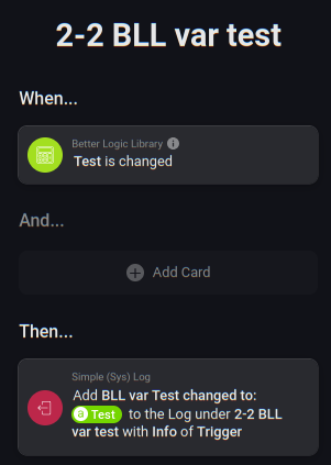

I’ve setup some test flows to see I can reproduce it;
The variable gets updated every 5s.
Update July 18th:
@Pieter_Pessers
I cant reproduce it with these 2 flows:

Triggercounts since yesterday evening:
Screenshot from 2024-07-18 21-25-54
Screenshot from 2024-07-18 21-25-21
Log (over 8000 lines, truncated because of forum limits):
2024/07/18$13156,2024-07-18T19:16:15.201Z,Info,Trigger,2-2 BLL var test,BLL var Test changed to: unmute
