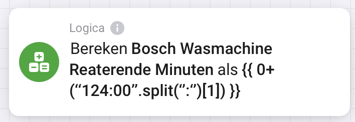

At this moment, I just have a ‘calculate numeric value as’ {{ 0+(‘‘124:00’’.split(‘’:‘’)[1]) }}
The ‘numeric value’ in homey → variabelen will be ‘empty’ when running this flow card. The app is crashing when opening the corresponding value in the list. I think that I make a mistake in taking over the symbols or something like that. But did not managed it to get it working :see_no_evil:

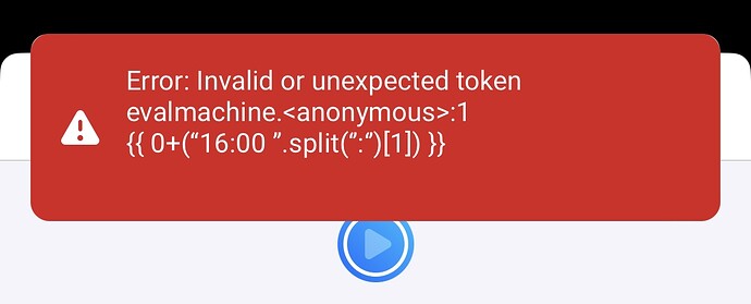

This is the error I get.
Hi Ranney,

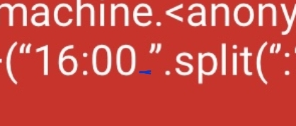

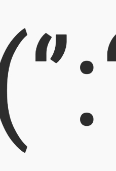

Never use fancy (cursive) double quotation marks in code.
You used two different types as well, probably two fancy single quote marks:
2.
Always use the standard straight double quote mark like: "
Also note, two single quote marks as a pair isn’t valid, only use the double quote mark symbol.
Also carefully watch for whitespaces, as shown in the error msg:
The (damn) autocorrect on phones/tablets can cause many unwanted issues when coding
Turn it off.
Okay, Ranney, this should work, just copy/paste it into your flowcard:
{{ 0+("124:00".split(":")[1]) }}

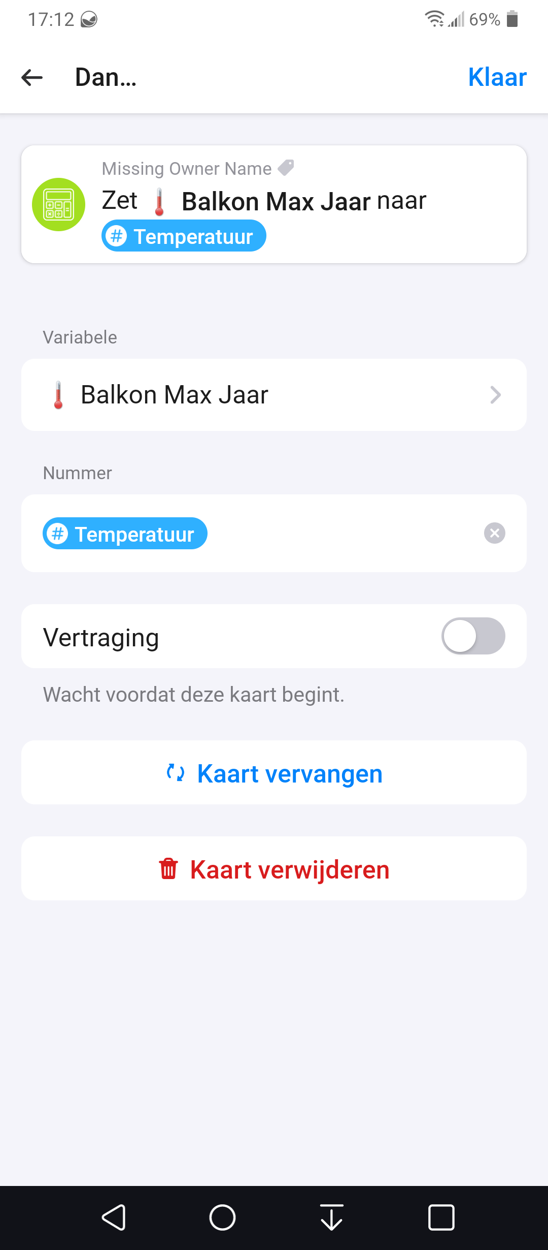

Have I missed something lately? many cards are missing owner name is that bad?
I think it still works?
Homey2019
It’s not app specific, Athom is aware
As far a I can tell the problem has been resolved with the latest upgrade. The downside is that you have to replace each card with this error. So for example if you have a card with set Hue scene for a zone with this error you have to replace the card with a new card set scene for zone xxx
