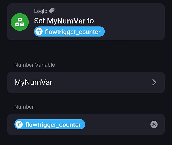

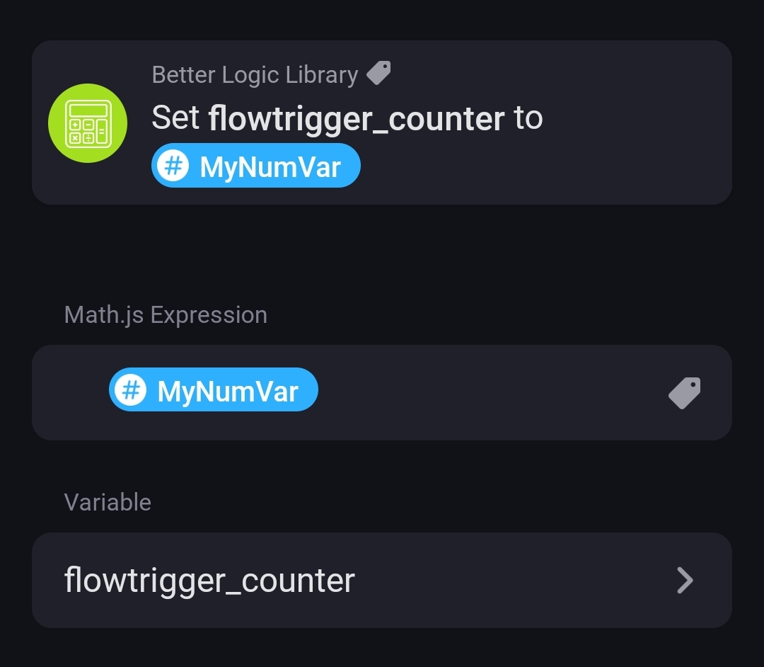

3. VarX_BLL=VarX_HomeyLogic+0.21+VarY
_

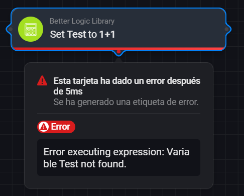

Why can’t I create variables automaticly from the thencard?
I have tried to save the flow and restart the application and nothing changes…
Am I doing something wrong?
Because “create new number” means you have to create the BLL variable once in the BLL app.
Actually, with most flowcards, the variable will be created as soon as you save the flow.
(Only not with bll expression, since the type could be number, text or yes/no)
Not sure why i wouldnt work tbh.
When finished entering the name, did you select it? Otherwise it won’t be added
“Create new number” it says.
Yes, I selected it :joy:
If you have the same version as me, could you test if it works for you?
Homey Pro (Early 2023)
Better Logic Library - v3.4.13
I just had to make sure, not everyone ‘gets’ it :wink:
So, I’ve just tested with both standard and advanced flows: works fine.
but:
advanced flow: I get the same error, when TEST running the flow.
So don’t operate the card in any TEST mode I’d suggest!

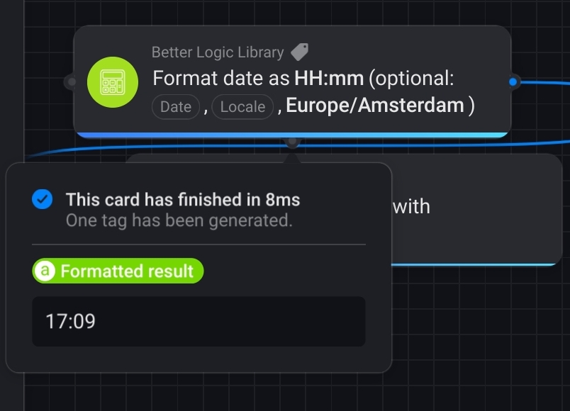

I’m trying to send myself a notification with current time plus the remaining time of a timer. (So the timer ends at hh:mm)
But when I try to store the current time with the second card at 13:03 the result is 12:03.
To correct this i can add (60x60x1000)milliseconds as shown in the first card?
Is this the best way to go?
Homey unfortunately works with UTC time, which was introduced in june, 2022.
Not sure if I understand your case right, but you can use this card below, which has the option to add your timezone and therefore it shows your local time instead:
@Arie_J_Godschalk
reminder :innocent:
If you leave it empty, your local timezone will automaticly be used.
But that’s the “big” Homey issue: sometimes the local time gets showed / used, sometimes the UTC time.
Generic (and non-tech) users often can’t tell.
My thoughts here were: better safe than sorry :wink:
