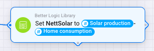

In the other thread you said I didn’t need the {{}} brackets. But it looks like from the example above I do need these {} placed around my expression.
So is the correct syntax any mathematically correct expression in {}. E.g. {variable1-variable2}, or {var1*(var2+var3)}
OK, so I don’t need any brackets. With a single set it errors.
Please show the flowcard.
And what error do you get?
This works
Screenshot 2023-07-11 at 4.09.01 pm
This errors
Screenshot 2023-07-11 at 4.09.38 pm
Needs to be double curly brackets, not single.
Indeed, you do not need brackets in the expression cards.

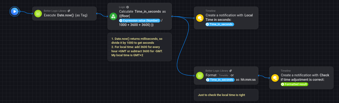

Can you please tell me if I can get “how many seconds have passed since the beginning of the day”?
Thank you for the great app!
Can someone help me in making a BLL expression for use in Device Capabilities?
I want to convert seconds to minutes.
Thanks!
@timvdhoorn: check here
Great, thank you!
