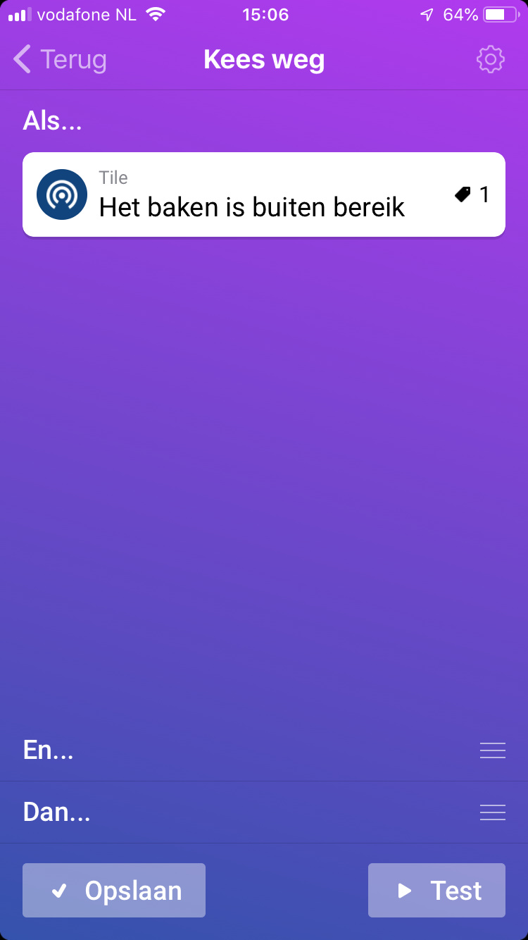

Hi. Not sure if I am doing something wrong here, but I have installed the latest app and added my Tile Pro. I also created two flows for testing. One has the trigger “The beacon is outside range” and then sends a notification “left home”. The second flow has the trigger “The beacon is inside range” and then sends a notification “arrived home”. Even if my Tile is approx. 6 m from my Homey, I keep getting notifications that I have “left home” and “arrived home” every minutes or so. Is this a normal behaviour?

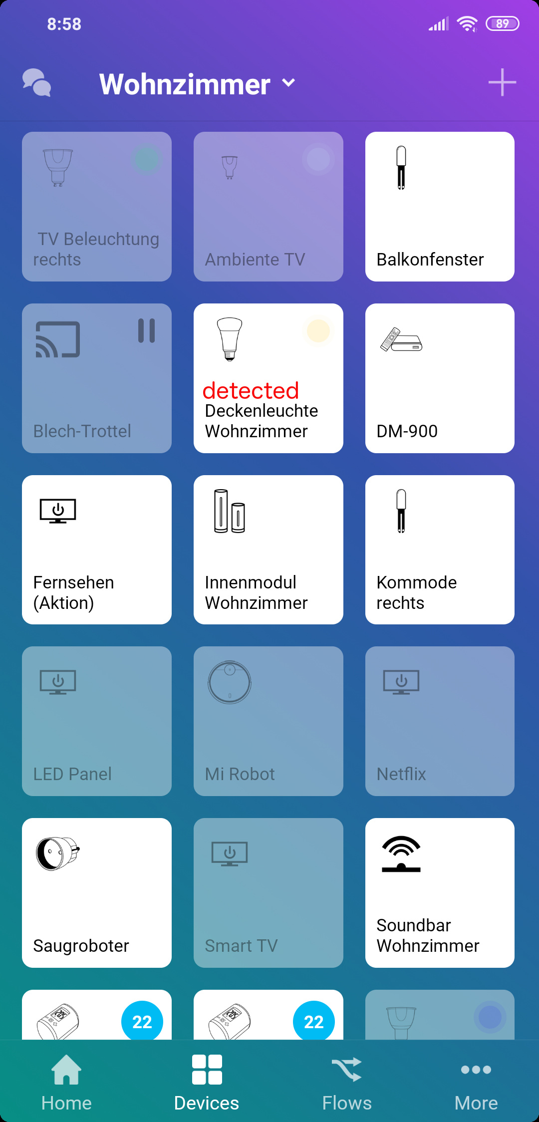

i made some screenshots to see exactly what i mean
at the moment all icons have the same “status”

This visual difference is (i assume) based on the state of the on/off capability that is not present at this moment in the app.

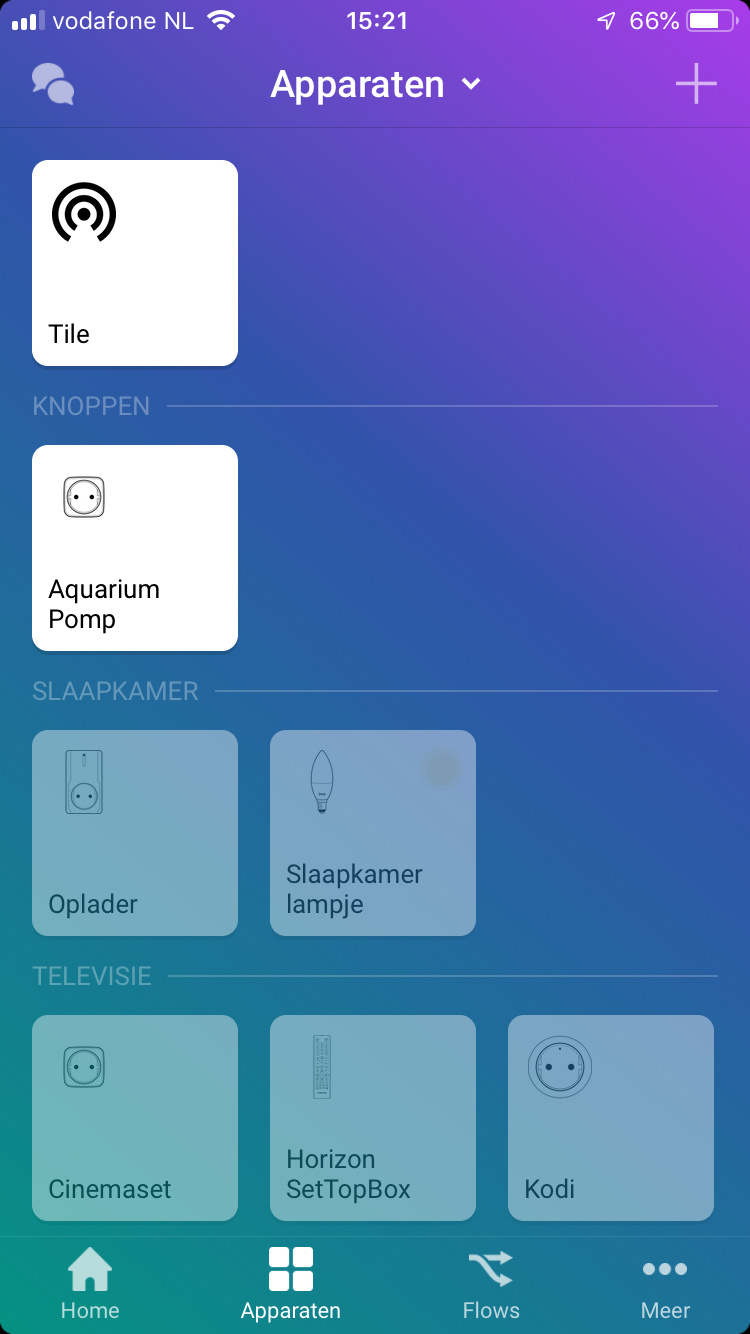

Problem with the Tile mate
The Tile mate is recognized in the app but does not respond to presence and absence. The testing is going well, but when I leave or come home nothing happens
I have removed the Tile mate app from the Iphone,
Battery from tile mate also removed a few times but also did not help, so I went to doubt the Tile mate but that works just on another phone. How are standing the privacy and location in homey?
