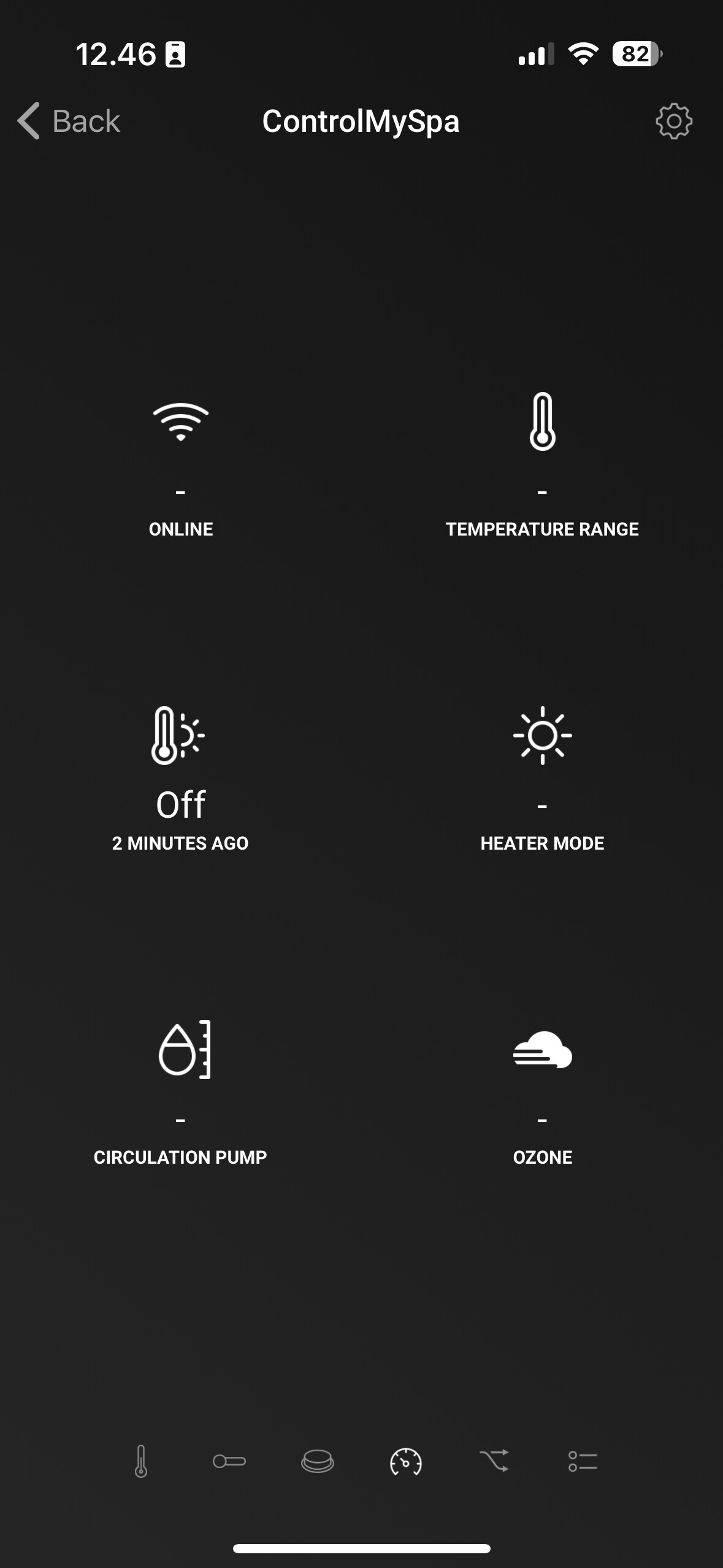

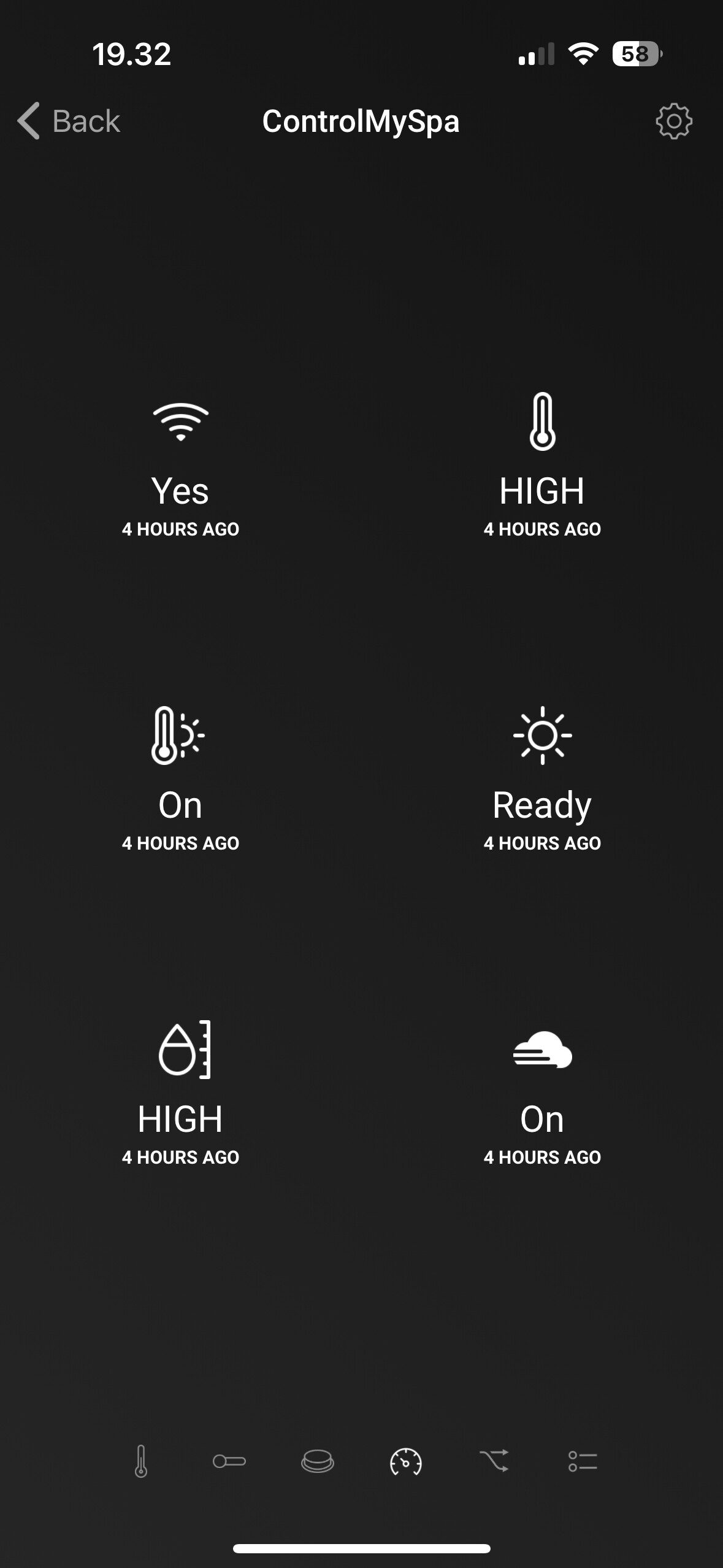

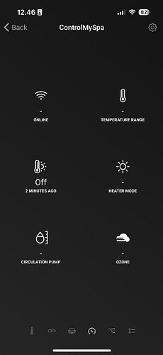

Something is still of. Did a restart four hours ago just to verify. Measurements do not update:
Diag sent.
@OH2TH strange, no errors and the data is updating. At least the api data is coming in.
So might be a stuck api on the CMS side
CMS mobile app works. Strange indeed. And after an restart on Homey, the app updated fine again.

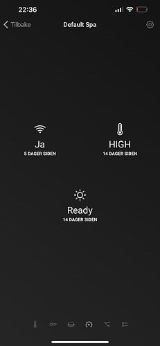

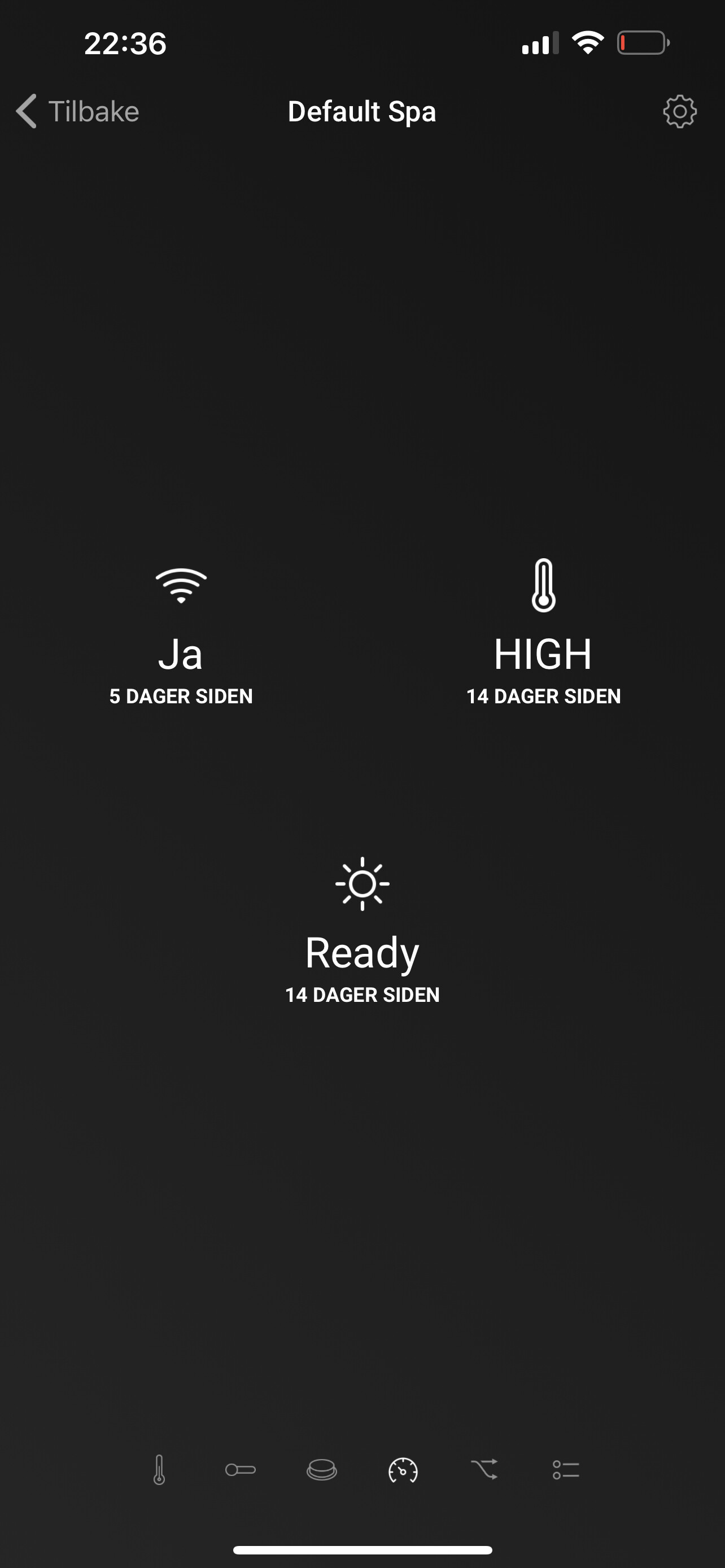

Heving issues with latest release, tried restart and reinstall, homey restart with no luck, CMS app is running just fine. Somehow the homey app is not indicating correct status online/ready and temprange, online 4 days ago. I can still send commands to the tub, blower pumps etc. The actual temperature reading seems to update sporadic as well.
Great app hope you get it running again
Hey @Jan-Erik_Klokk
I do see errors in your logs. Dont see the relationship with the last release but will try to make a fix tomorrow :slight_smile:
