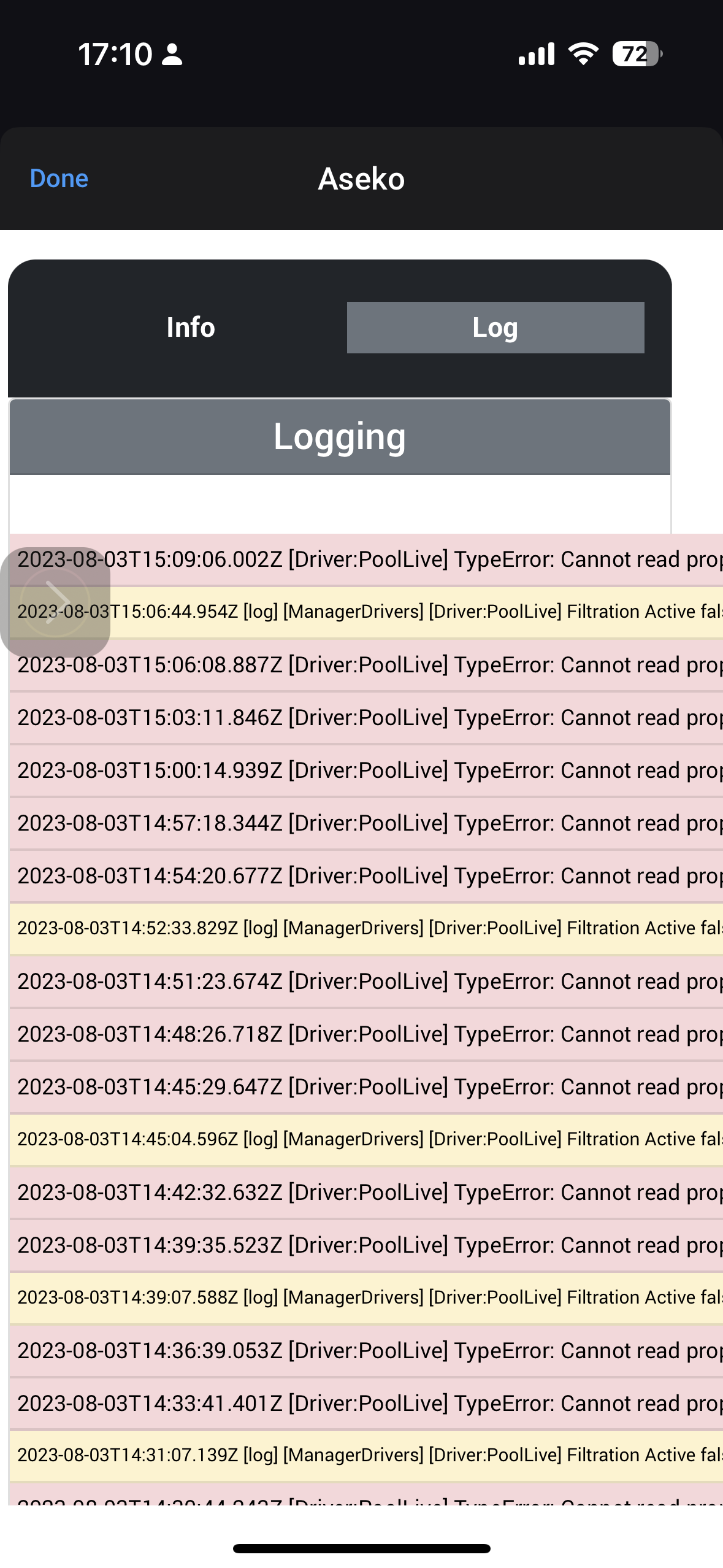

not working after update When "Pool filtration started/stopped
What is not working?
when I use it in flow, it doesnât respond. WHEN âfiltration startedâ THEN send notification. but nothing happens.
Strange, I see things happening here, I will do some more tests.

evaluation of the AND condition still ends with an error and When does not respond to start/stop filtering. Will it be resolved?
Will make some time to dig deeper into this second half of this week.

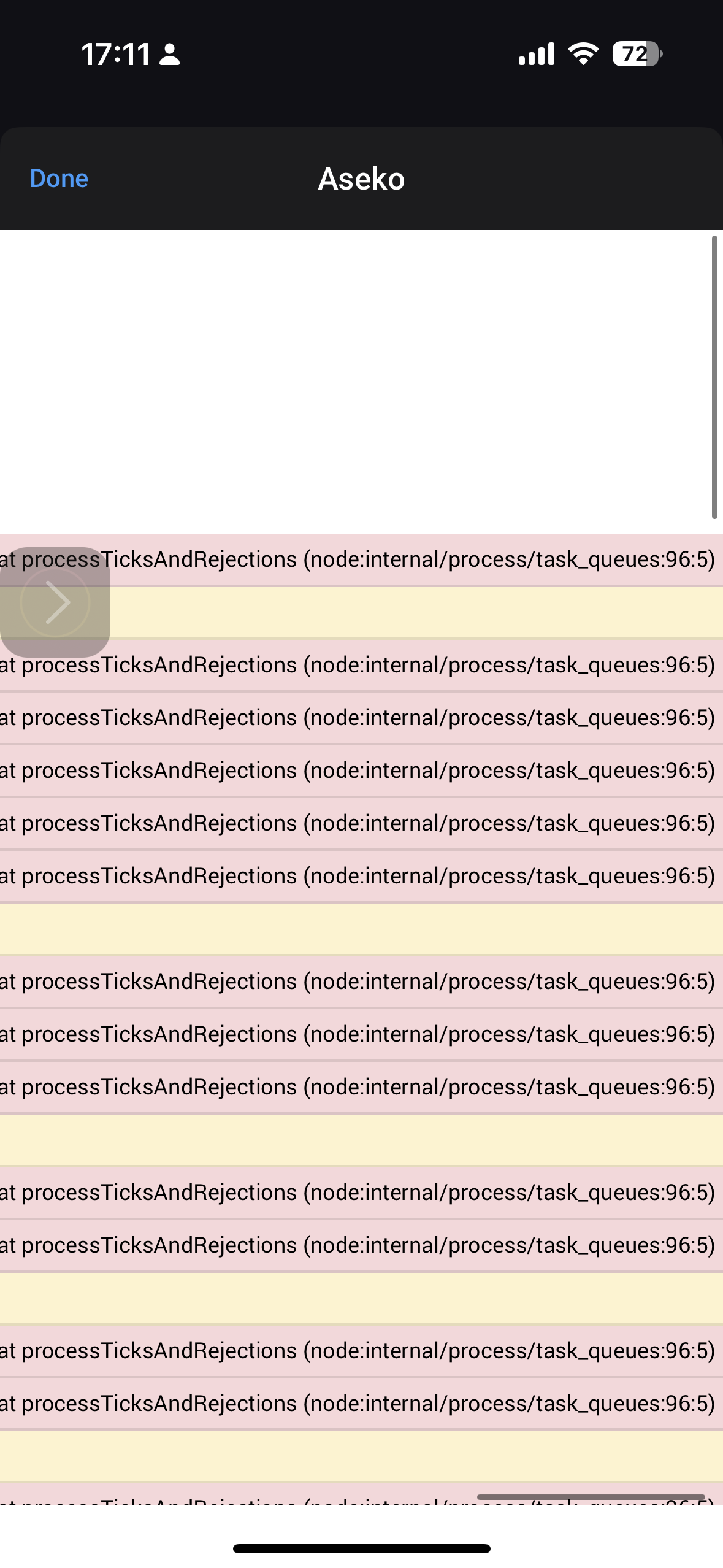

Could you do a recheck with app update 1.4.0
now it doesnât end with an error, but both AND and WHEN still donât respond to the filtration being turned on⌠Always stopped
What times are your filtration on and off again?

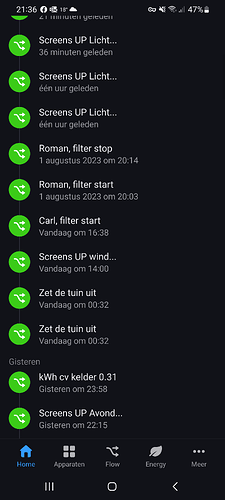

morming 3:40-5:55 and afternoon 14:15-16:15.
I tried it today 19:59-20:13.
at the beginning there is always a protective 8 minutes just filtering before all functions start
The problem with the unit is that I need to poll the status for everything, it does not actively informs the program that something has changed. Now I poll every 3 minutes on all statuses including of filtration is active (I look at the times defined in required). So in the current situation I can be 3 minutes off
. So need to think of a way to not excessively Poll the units and get what we need
