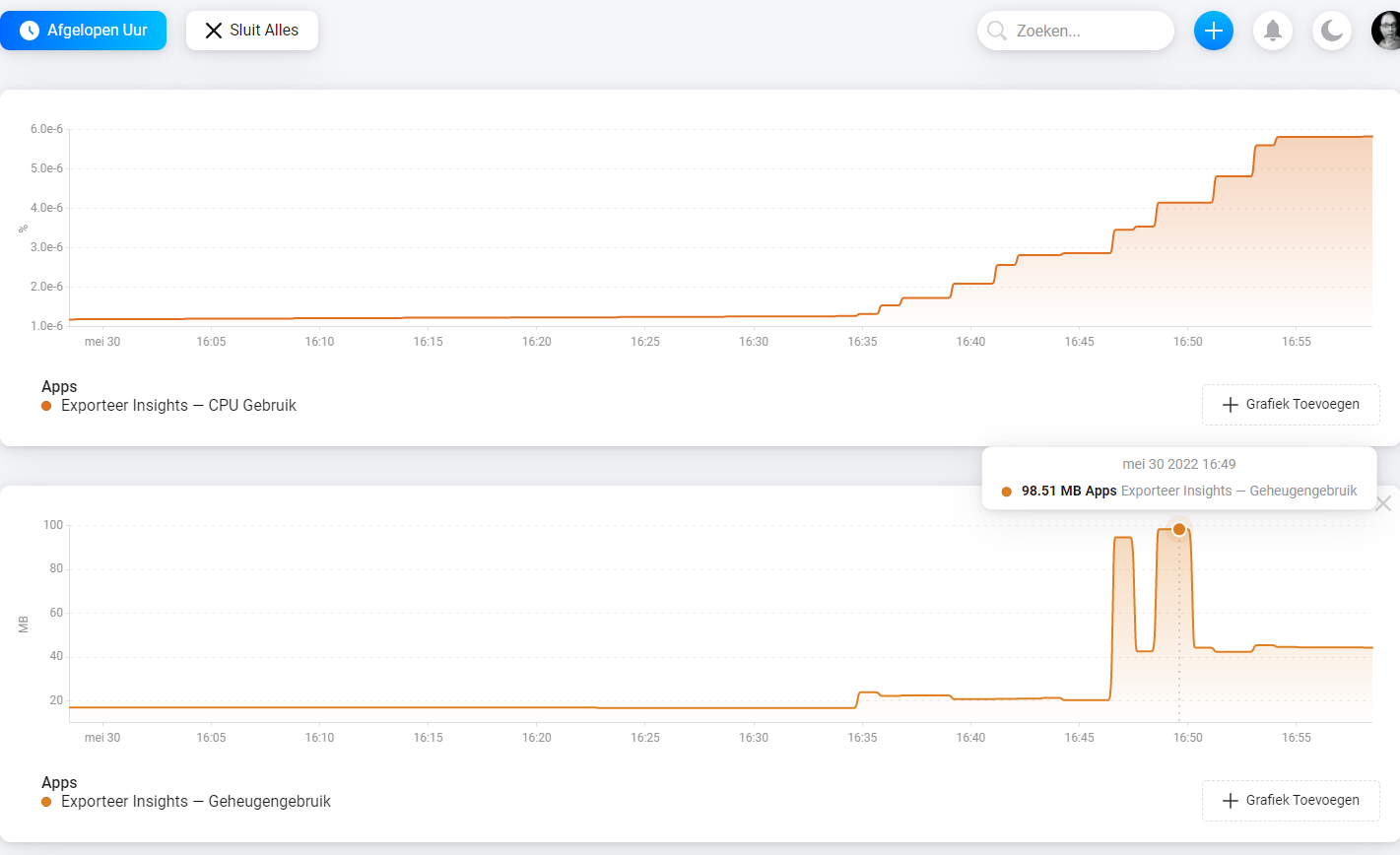

Also, I noticed that the last log line states: “Finished all exports”. So, the process is finished. However. The memory and CPU of the app remains high:

What is the system load doing during an export? I could build in more relax-time for Homey, but I am not sure if that makes sense, even more because the export duration would drastically increase.
Just performed an export again, the uses 98,5, mb during export. When finished, it drops to 44.5 mb. Still a lot actually.

Maybe you should get a faster Homey Pro or remove some apps?
Yeah, a faster Homy is probably not far away. I hoped to postpone for a while. I am really using al the current apps.
