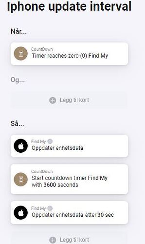

Hi. I’ve been trying to understand how the app and Apple work together. When things are updated and so on. It look like the update regarding charging and battery status is one step behind, and of cource the battery drain. So when we set update to 10 minutes, it will go 20 before the battery is reported correct. I have set update interval to OFF, and trying to see how this works when I control the update, using CountDown. As reporten in the diagnostic, this did not work for long (1.0.9). When restarting the app, it start working again. Installed 1.0.10 to see. In my test, I send two updates. It is currently set to 1 hour because I also have to get a disant battery drain history first.

Hi again.
Just sent you two new reports. One after the countdown ended, and one with manual triggering my flow. No updates in the app.
PS: After update to 1.0.10, the app set 300 sec update intervall. Turned OFF. Then I pushed my two command, ref pic, manualy. It worked. Now, 30 mins later, the countdown finished, but could not update.
