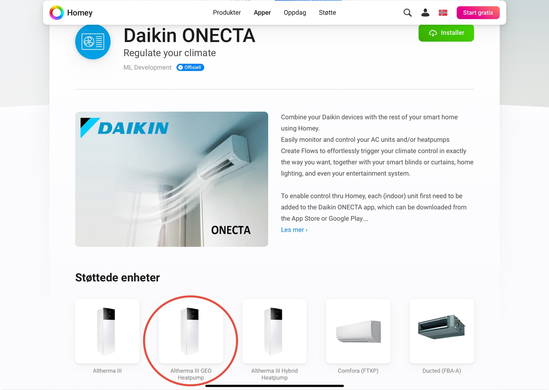

Does anyone here have experience of controlling a Daikin Alt 3 GEO (rock heat pump) based on indoor temperature instead of outdoor sensor? I want to connect the pump to one of my existing indoor temperature meters (Netatmo or Aqara) which is already integrated in Homey. The aim is to optimize the heat inside and at the same time utilize smart power saving via Tibber. I have both Tibber and Daikin ONECTA in Homey, but am a bit unsure of how best to set this up. Does anyone have good tips, suggestions for setup, or flow experiences that can make life a little easier? All tips and advice are greatly appreciated

Does anyone know if the Daikin Altherma R Hybrid is supported?
Did you check the app page?
Yes I see only Altherma III Hybrid in the list and not Altherma R.
Did you read this thread?
Somewhere it said: If it’s is connected to Daikin ONECTA app(android/iphone) it also should work on homey. If not contact developer
Do you think the term Hybrid on the app page covers also the Altherma R hybrid? Unfortunately Daikin uses different names for same models. So simply try it!

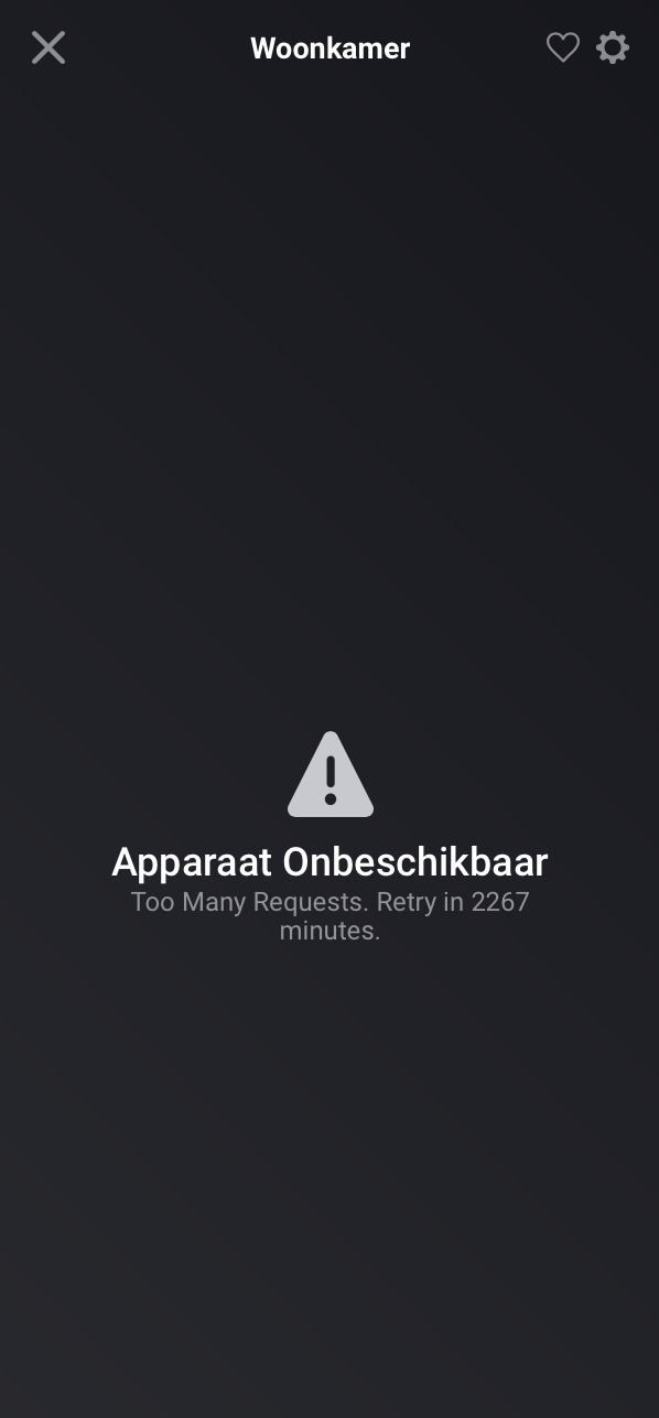

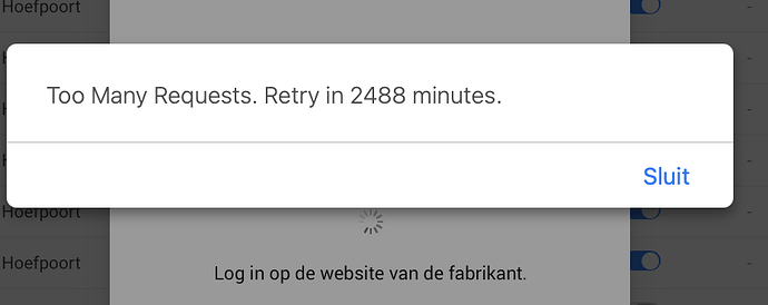

Since the last update to Daikin ONECTA v 4.7.0 the airco units are not responsive through Homey Pro.
I’ve tried to ‘repair’ them but it gives me the error: “Too Many Requests. Retry in 3758 minutes.”
Please advice, I have 11 units connected, they were all controlled though homey . I need this…
@WillemG Maybe you can show your flows so that people can see if there is something wrong with it and that you can change your flows.
Question, is for every device maybe a flow that is used every minute? Or something like that?
