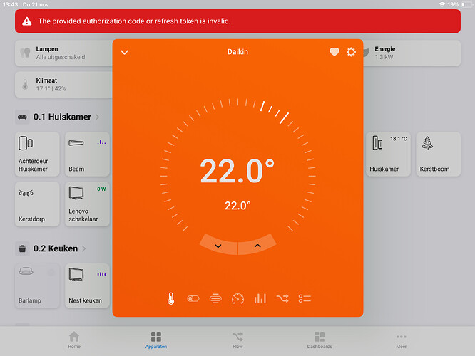

Since a few days I have troubles again with the connection with Daikin.
This is the diagnoses report: bcbc662c-2d86-434e-821c-a172582f72d9
Thanks for your help in advance

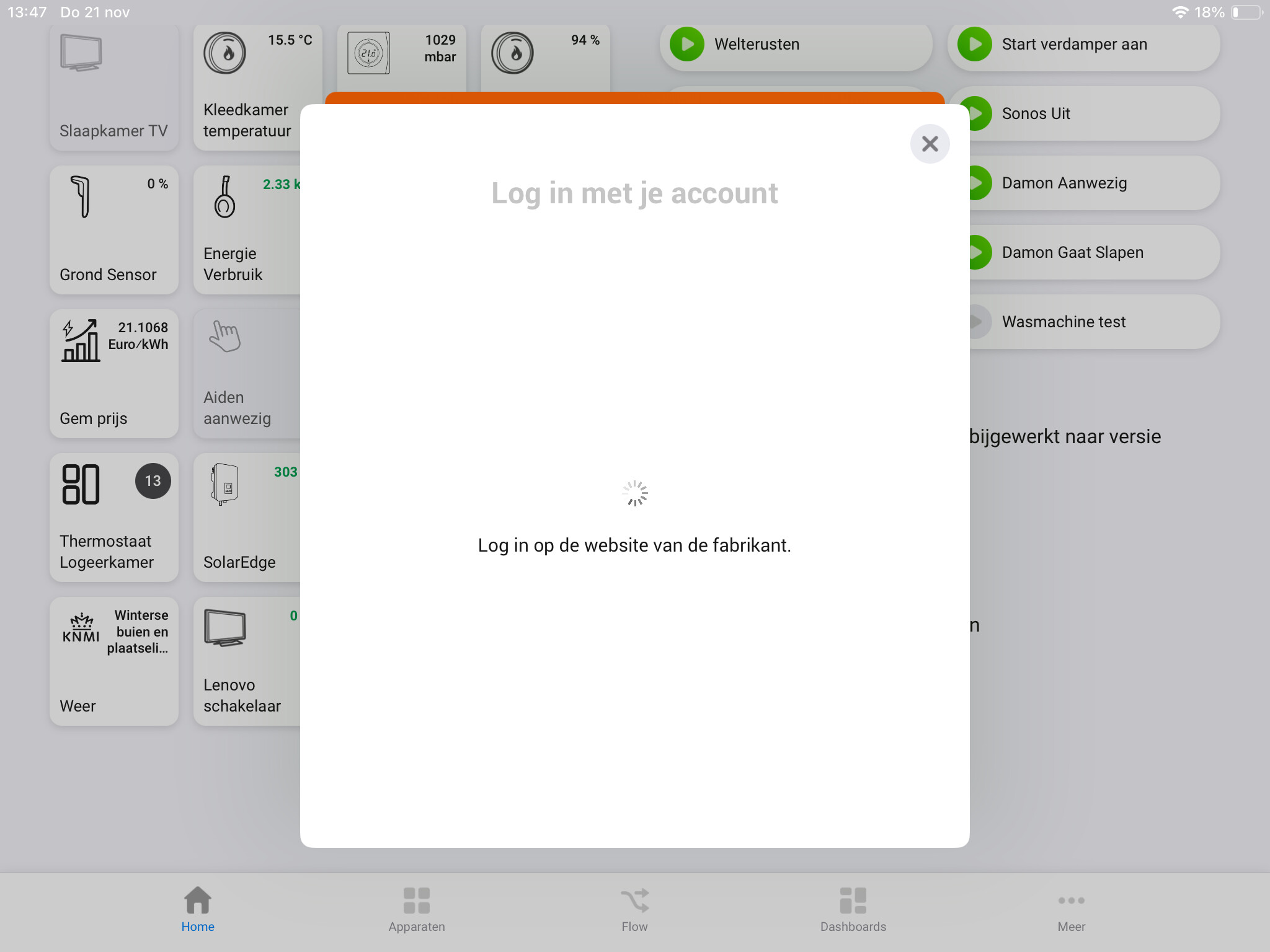

This is what I get when I want to repair:
(This time it is the correct account, I removed the wrong account before).
Looks like daikin had revokes als access_tokens.
simple repair all you daikin devices in homey and to be sure also restart the homey daikin ONECTA app.
