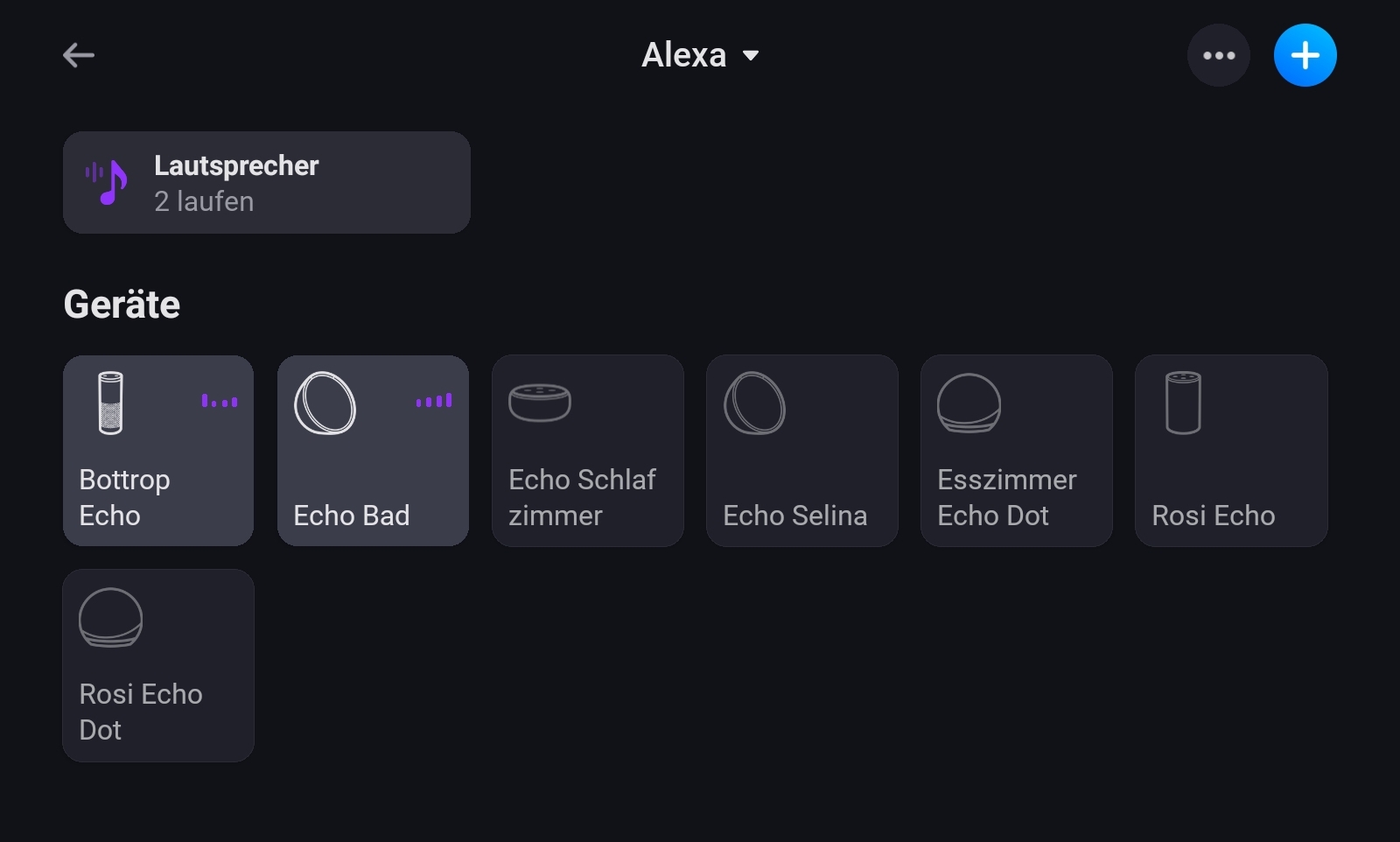

Every morning I have an exclamation mark on the AMAZON ECHO icons and nothing works anymore.
Restarting the app doesn"t help. I have to “Reset”, “Reconfigure” and log in again every time… Then it works until the next morning.
