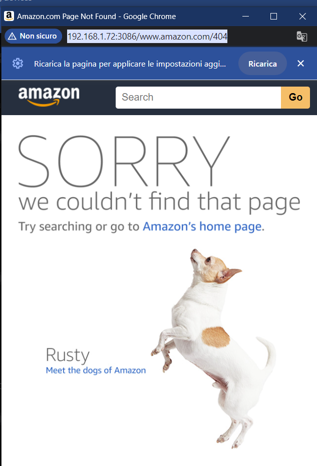

I installed Amazon Alexa APP. I’m trying to add an Alexa device without result. As soon as I choose a device, I’m asked to log to my Amazon profile. When the pop up opens, is very difficult to insert the code, because of continuous refresh, and when the code is inserted a message with paga not found appear.
Any idea?
Thankyou
Hello , i have the same problem
Same here :slight_smile:
I am also having the same issue as the posts above.
Same problem, Page not found :cry:
I had the same issue. Solution: you must go into your Amazon account via web browser and enable 2 factor authentication. I did this and ran it through my Google Authenticator and bam, problem solved. I was then able to integrate all my compatible Echo devices. Use the code that comes through the authenticator app, not the one that Amazon texts to you. Hope this helps.
Thankyou, this works!
