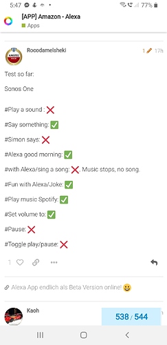

Hey Jamie thanks for the amazing app. Ive just added the sonos beam and had the same outcome as Rocodamelsheki results.

Play/Pause doesnt work with grouped items, just confirming that your Sonos one isnt in a group?
Was grouped yes, wil test ungrouped tonight
Sorry and just to confirm that alexa annouce and alexa whisper both work correctly?
Will report back tonight m8
3.2.502
Has been released to the test channel, it resolves some issues with third part features
- Removes Simon Says from Sonos One, Sonos Beam and Orbi voice.
- Removes whisper and announce from Orbi voice
- Removes ‘sounds’ from Sonos One and Sonos Beam

They can be in a group, but you cant control the media (play/pause) of a group from an individual device. As far as Amazon is concerned a ‘group’ is a completely different device, but only for media commands apparently.
I had a similar problem, you can set up alexa to ‘play to a group’ automatically when you ask for music on a specific speaker. "play to all upstairs by default’ my app will actually coorectly trigger it … but then you can no longer control the songs using the app and it can throw my app off …
I hope that explains it.
Ok. Tested with 2 One’s in a stereo pair: same result as above. Whisper and announce does also not work, just speak!
Not gonna unpair the speakers because that’s too much work. They are wall mounted and the mount itself does also have to be removed to reach the pair button.
If u want me to test anything specific then plz lemme know.

I have 2 Sonos One’s. A Gen 1 and a Gen 2. These are Mono Speakers (no pairing). On both i have the same result as @Rocodamelshekima : No Alexa announce and no Whisper.
