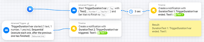

Hi @Arie_J_Godschalk Is this app still alive?
It could resolve one of my key issues with sometimes writing simultaneous messages to a log.
I cannot get it to trigger the second row.
I think you need to save the flow between adding the then card (to set the trigger name “TriggerDuration1var”). Then it will show up in the when card. As you already have saved your flow, try to re-add the trigger name in both cards. Did you select “create” when adding the trigger name in the first card?
Yes it is!
Are you on the HP2023 btw?
Thank your for your answer. Yes to all your questions. On the second row I could select TriggerDuation1var from the dropdownlist.
But I redid everything again according to your tip with a new triggername but still the same problem.
I have a Homey and a Homey Pro from 1-2 years ago.
Update: It always helps to sleep first, then try again. I found I had disabled the flow. Apologies :blush:
