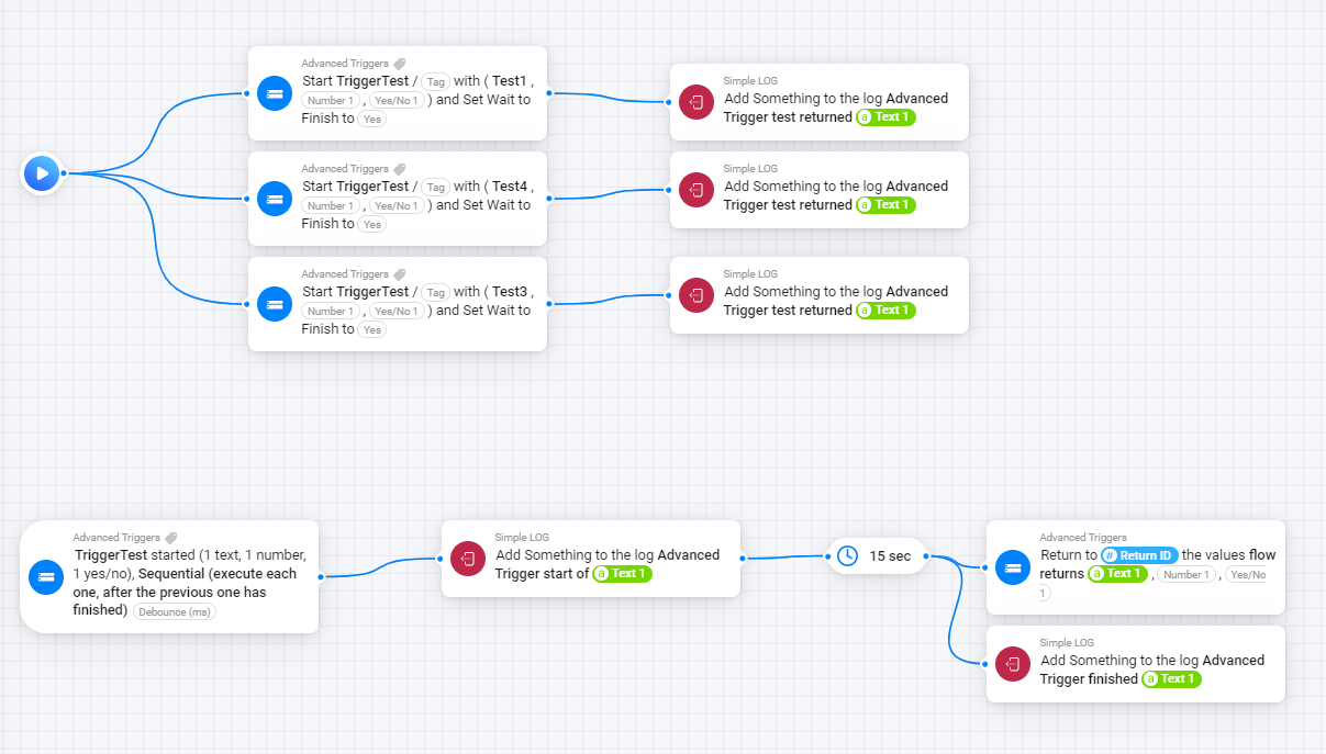

Tested it and the sequential part works good, each trigger is handled after each other.
But I see a strange thing with the return-card.
See picture for flow.
The two first calls returns the value, but the third and last doesn’t return any value.
Simple log printout
2022-11-01 19:06:35 Advanced Trigger test returned
2022-11-01 19:06:35 Advanced Trigger finished Test3
2022-11-01 19:06:20 Advanced Trigger test returned flow returns Test4
2022-11-01 19:06:20 Advanced Trigger start of Test3
2022-11-01 19:06:20 Advanced Trigger finished Test4
2022-11-01 19:06:05 Advanced Trigger test returned flow returns Test1
2022-11-01 19:06:04 Advanced Trigger start of Test4
2022-11-01 19:06:04 Advanced Trigger finished Test1
2022-11-01 19:05:49 Advanced Trigger start of Test1

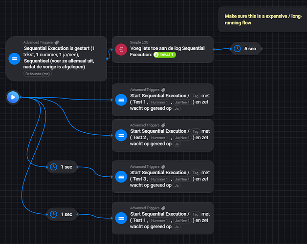

Straigns think here is, the Returned Test3 should give an Timeout error: You are surpasing the 30 seconds timeout for an actioncard to finish.
The Start TriggerTest (Test3) should timeout aftter 30 seconds.
What is this 30s timeout? Something Athom implemented? So no action card (in this the Start card?) may wait more than 30s? I will add error check to the flow.
Sorry, i just tested it, and it turns out to be 60 seconds for the timeout.
Indeed, a flow itself can run for a long time, but each actioncard (and i think conditioncards too) must be finished within 60 seconds, or (also in the flow editor) you will recieve an timeout (Network request failed.).
When i run this for instance: Al goes just fine, after 5 seconds the flowcard is done.
But when i run it for 65 seconds i recieve an error:
The 0s is wrong! It runned for 60 seconds before the error cancelled it.

I changed the delay in my flow to 1s but still get no return value from Test3.
2022-11-02 13:52:02 Advanced Trigger test returned
2022-11-02 13:52:02 Advanced Trigger finished Test3
2022-11-02 13:52:01 Advanced Trigger test returned flow returns Test4
2022-11-02 13:52:01 Advanced Trigger start of Test3
2022-11-02 13:52:00 Advanced Trigger finished Test4
2022-11-02 13:51:59 Advanced Trigger test returned flow returns Test1
2022-11-02 13:51:59 Advanced Trigger start of Test4
2022-11-02 13:51:59 Advanced Trigger finished Test1
2022-11-02 13:51:57 Advanced Trigger start of Test1
Do I do something wrong?
