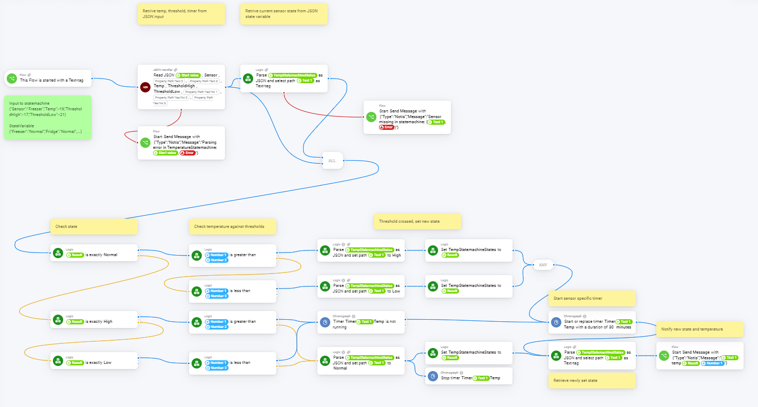

I have some temperature sensors I want to check whether the temp is ok/high/low.
Before I found out that advaced flows could parse JSON I clone the temperature check flow for each sensor.
With JSON I could make one generic check flow and send the new temperatur value, high and low threshold and sensor name. But as Homeys built in JSON parser cretes tags named “Result” I got an unreadable flow with “if(Result < Result)”. It worked but looked terrible.
Then I found your JSON parser and at least now I have “if(Number1 < Number2)” and it is easy to take a quick look in the parser card to understand what they mean.
Homey-temperature-check
With your Advanced triggers I would still have “if(number1 < number2)” but I would need to remember what “Number1” was as there is no explaining label for it. And when starting the event I would need to check the called flow to set correct arguments. So, a bit back to Homeys JSON parsing.
This is where it would be nice to have tags with own labels, and I could have “if(temperature < thresholdLow)”.
I could achive this with Homeyscript but I like to have the flow grafically if possible.

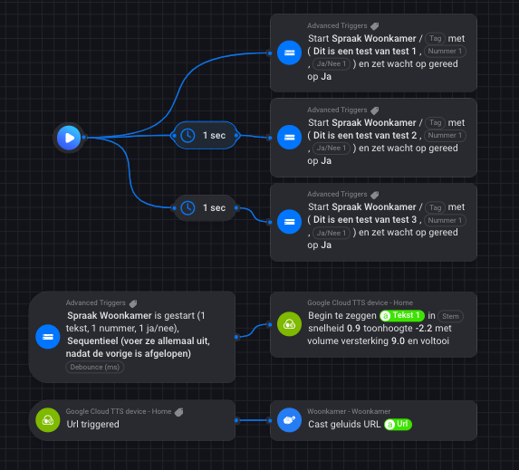

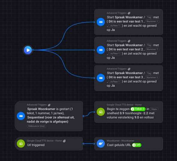

When I use your example with delay blocks for the 2th and the next ones it works, but when from 2+ flows got triggered at the same time it is not doing anything. Setting trigger mode to standaard, all 3 texts are coming out but not sequential offcourse.
Works:
Doesn’t work:
Feature request would be to know when the last queue trigger is finished to trigger music again on my chromecast.
