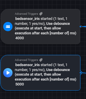

I think I have the same problem. See triggers below.
Scherm­afbeelding 2023-05-25 om 18.26.38
The top one works as it should, but the second trigger doesn’t work.
It seems there is some randomness as to which trigger cards work and which don’t. How do I create a ticket?

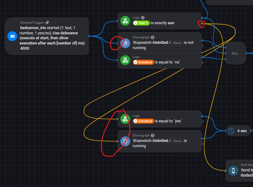

Thanks for the TEF, that helpt a lott, since the issue is not with the action/Then cards, but how you have setup the triggers/When cards:
These 2 triggers are considert as one card, since all arguments are exactly the same.
And since you have debounce on, it will make sure a trigger is only fired once every 5 seconds.
Thus, the above trigger is fired from your first action/Then card, but the second trigger will not fire within 5 seconds.
To do this, you need to change the flow a bit:
You now have (i love TEFs :slight_smile: ):
Change this to:
Now it works if i trigger any of the action/Then cards you have.

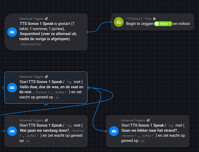

Example for the HP2019 and older models:
N.B. the top right flowcard is the condition-card of Google Services. The action/When card doesn’t wait to finish, the condition cards do.
The left top card needs to be set to Execute Sequential.
The lower 3 cards are just examples. No matter how you execute speech from now on, it will always go sequential: It will wait for one speech to be finished, before the next one is started.
No matter where you execute the flowcards from!
