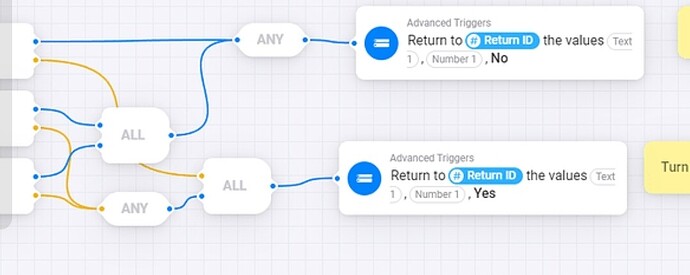

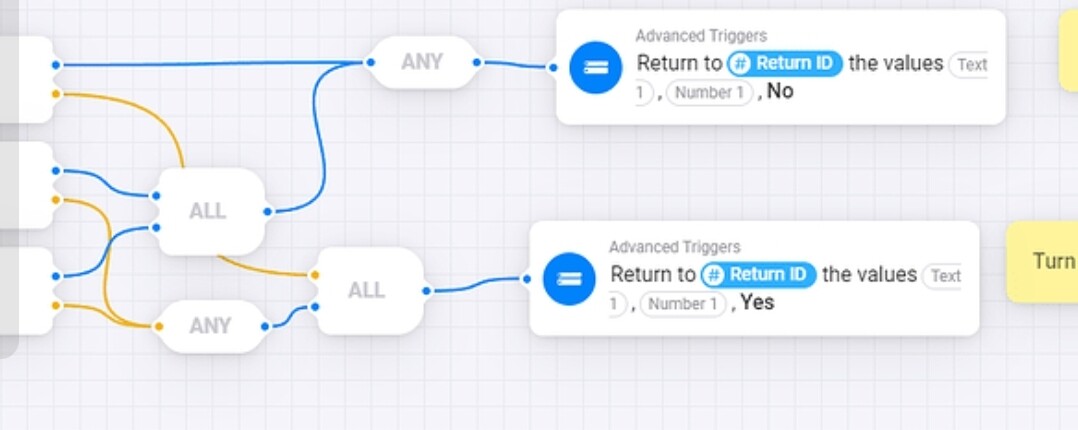

Really new to this app (like under one hour), but I was told I could fix my issue using it.
What I was hoping for was to be able to define some commonly used logic and call it from my flows. I’ve set it up as follows (and I think that should be right), but I’m unsure how I can call it from my flow and return true/false or 1/0 or whatever - and then handle the rest of my flow based on the exit state.
Anyone got any tips for me? Cheers!
You should end the flow with the card “Return to” and add the ID tag from the start card.
By this the result will be forwarded to the start card, to which you will continue the starting flow with the results.
Thanks.
I tried the following, but “SensorLogic” should return “no” but the logic in the lower (calling) logic gets a “yes”. If I’m completely off, would you happen to know an example I could have a look at?
I think Arie needs to answer on this.
@Arie_J_Godschalk Think you can help me out with my query above? The app looks like it has awesome possibilities - I just need to understand it :stuck_out_tongue:
Surprised it doesn’t return “IDK” :blush:
I cant follow the spaghetti…
First add timeline cards in parallel to the "Adv. triggers cards with “yes” and “no” cards.
This way you’ll discover what actually happens, and if it actually sends “Yes” all the time or not.:wink:
Yeah, the spahetti is why I want to move this part of the logic out of the flow and rather use it as a function. Also, I need it in a few places and it’ll just clutter everything…
Anyway - I tried to insert timeline functions, but it doesn’t even seem to be starting.
I’m starting it with the lower code snippets (just trying to figure out the basics before I insert it into my flow…
What happens when you test run the flow from the top left card?
